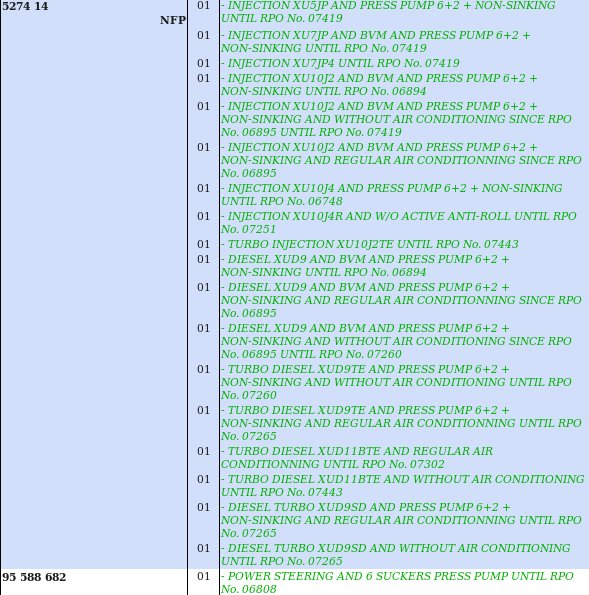

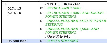

Hei!axbx wrote:So I got hold of a new pressure regulator(as in the base of the main accumulator sphere..) from a Xantia, unknown year, but its part number is 588684.
As far as I know, there should be three different models of pressure regulators for BX:
# 5724 14 for BX 1,4
# 5724 16 for diesels and petrol models without power steering (or with 6+2 pump).
# 95 588 682 for power steered models (without 6+2 pump).
All of these and a couple of others can be found on different Xantia models. However, my catalogues give no hits for the number 684 you provided. Are you sure the last digit is 4 and not 2?

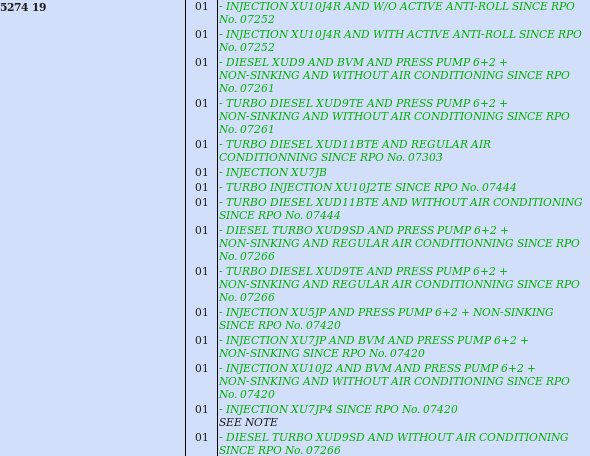

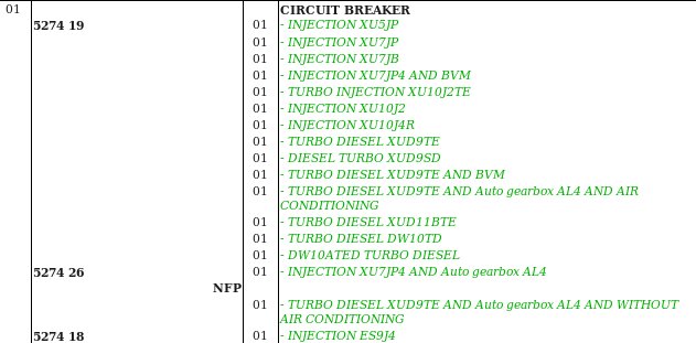

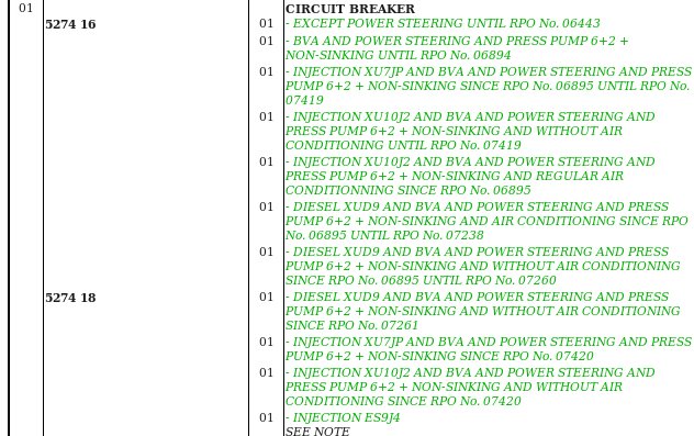

As I said above, there are 3 different regulators for BX:axbx wrote:I see, do you know what other citroens have this regulator?
Since yours is apparently a turbo diesel with power steering, I seems as though it should have the # 95 588 682 - however, I have learnt that these lists do not always produce the correct part #, so there's a small uncertainty.
In Xantia mk I, there's the following set of possibilities:
If we assume the # 95 588 682 was indeed the correct one, there's your list of Xantia mk I models that should share the same regulator.
Finally, for Xantia mk II there's yet another list:
So no matches there.
My guess is that this 95 588 682 would be the only regulator with three connections (i.e. meant to be coupled with a flow distributor), whereas the other models would be for the those models which either have no power steering or the power steering feed comes directly from the 6+2 pump and not from the flow distribution valve. But that's just my guess, I have no actual experience on Xantiae.
