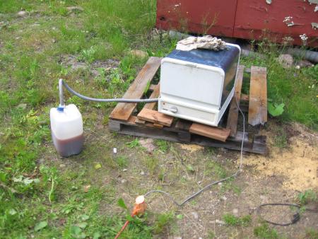

The old dishwasher was waiting to be recycled as scrap metal, and while it was there, I thought to give it a chance to do the last service by washing my tools after the wishbone exercise. Filled it with diesel fuel, disconnected the heater element, and let it run.
Worked nicely for a couple of months, but at the end, didn't save it from recycling, since my Wife disliked its decorational characteristics.
