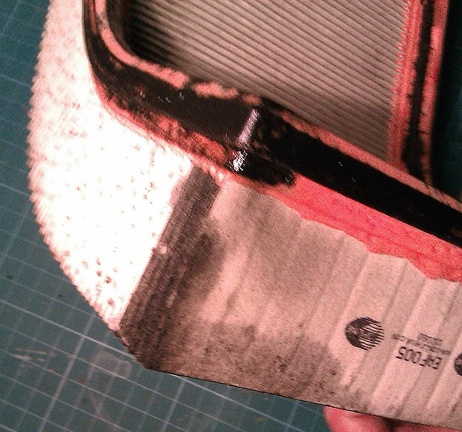

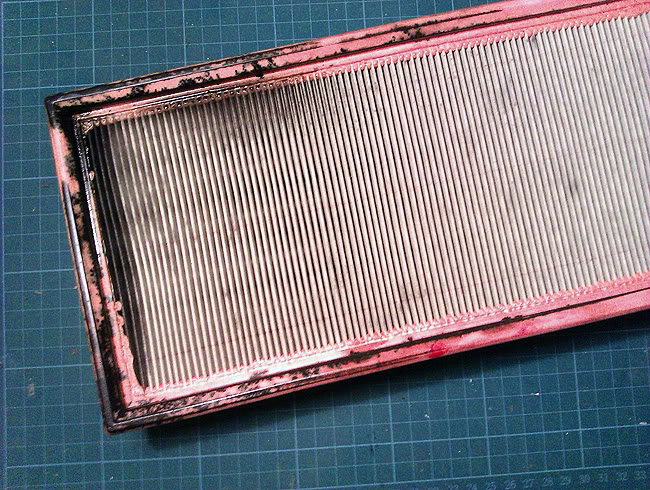

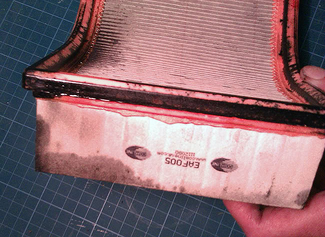

I've just replaced the air filter in my car with a K&N. When we removed the old one (well, when Mulley removed it!) it was covered in oil at one end (see pics) - anyone know what might be causing it? Is my car about to blow up!? I suspect the old one may have been in there for some time.

It's supposed to be like that. Have a look at where the breather pipe from the oil filler pipe goes...the filter catches the excess oil vapour. Don't worry, just keep driving it.

Oscar wrote:It's supposed to be like that. Have a look at where the breather pipe from the oil filler pipe goes...the filter catches the excess oil vapour. Don't worry, just keep driving it.
(I suppose I should have said "Car's a write-off, mate, I'll take it off your hands for 50 quid")
That's the right answer - jolly good! ( not the 'I'll take it off your hands for 50quid' bit obviously)

Was gonna say that doesnt look to bad to me Paul, its when you can "wring it out" you need worry. The one on the TZD wasnt much different oil wise but was alot dirtier!
It wasn't too bad, but was worse than anything that i'd ever seen before including my tzd turbo, so suggested to Paul to post up a piccy incase there was an issue? The good thing about the K&N is that it can be cleaned if it does get gunged up which i said i'd do if Paul keeps an eye on it.
