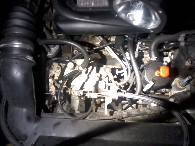

It goes to the fuel pump to advance the injection timing when cold. Not 100% exactly where on the (more common) Lucas pump which I'm assuming you have, but recently got another BX with the Lucas system so will have a look tonight.
It doesn't make a massive amount of difference in my experience - the timing advance on my van (with a similar pump) is manual and the handbook states that you only need to touch it in sub zero temperatures. I'm going to replace mine on the BX as it does not function, but the only symptom is an ever so slightly rough idle for the first couple of seconds.

If you have a Haynes there is a good pic there of the cable position. You need a nipple of some sort to fit on the end though.

Cheers for the picture. I can't quite see where the cable goes, but there are only so many options I suppose.
