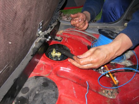

The fuel gauge doesn't work on the Mk1. Well, occasionally, it sort of bounces up to where it should be. Briefly. My guess is that the sender is borked. So, how do I go about solving that issue? Do I have to drop the tank?

Just lift the rear seat. The sender unit is below the round plastic cover in the foreground of the picture:Dollywobbler wrote:The fuel gauge doesn't work on the Mk1. Well, occasionally, it sort of bounces up to where it should be. Briefly. My guess is that the sender is borked. So, how do I go about solving that issue? Do I have to drop the tank?

Depends on the failure mode. I keep one two spare ones that I can quickly fix in position in case of troubles, and then take my time off the critical path to go through the removed one. Usually they can be fixed.

The problem with the fuel sender may well not be where the connector plugs it but in the actual fuel tank unit.
It is a simple job of unscrewing and remoing the metal cylinder that drops into the fuel tank.......However most likely you need to replace that unit if you can source one.
*********BEWARE OF PETROL VAPOURS AND EXECRCISE SAFETY IN A WELL VENTILATED AREA WITH FIRE PROTECTION ON HAND***********
That means no smoking, naked flames (including women) or sources of ignition (disconect battery).

Our car had been in for some welding on the sills and the tank needed removing . From then on the fuel gauge was working like a yo-yo. Finally got around to looking at the problem and found the electrical connector was barely fitted on the tank.
A few months later and the gauge did not work again . I knew what to do this time
I know, I know.
Any way if it happens again , I'll cable tie it on !!!!!

In my experience, that's usually not a big issue with an RD.kiwi wrote:*********BEWARE OF PETROL VAPOURS AND EXECRCISE SAFETY IN A WELL VENTILATED AREA WITH FIRE PROTECTION ON HAND***********

Just been out to fix these two problems.
Fuel gauge sender - I reckon it was gunked up. Removed by unscrewing the plastic threaded ring and then I could pull the unit out. Bent out the two metal tabs that hold the plastic cover at the bottom off. Quite sludgy inside. Didn't look like fungal sludge thankfully, and the metal cylinder itself was clean bar a covering of diesel. De-gunked it all, squirted some contact cleaner on the connections just for good measure and it seems to be reading properly. Reminding me I need to get some fuel...
