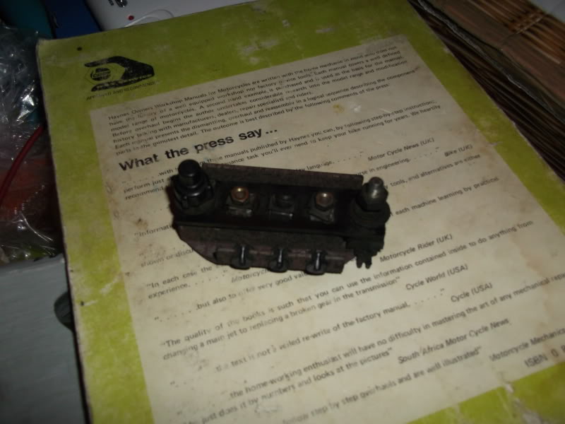

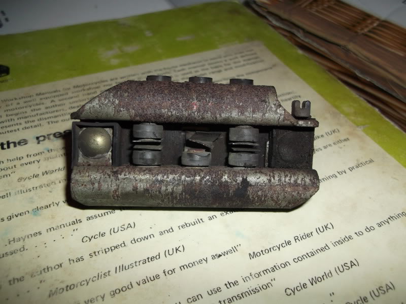

This seems to be a connector block joining 3 wires from the windings to the main output terminal. The centre nut was loose on the 3 terminals, but when I tried turning it the bolt turned too. On removal I looked underneath and found this:
So this needs either rebuilding or replacing, and I'm assuming that the alternator must be on just 2/3rds power, explaiing the low output.

Is this the same unit - different view?
http://www.iat-usa.com/catalog/images/08306.jpg
not ideal location but maybe a starter!
http://www.iat-usa.com/parts.html
search the parts ca for alternator - rectifier
then look up the parts that it replaces and you come up with
possibly this? http://www.woodauto.com/Component.aspx?Ref=RTF4929
Is it a brushless alternator? if yes I suggest that you talk to woodauto.
Thanks for those links. It's not exactly the same (it looks like it has an earth lead that mine doesn't), but it's certainly the right general shape and for the right power output range.
The spare alternator turned out to be completely dead! A mate recons he may be able to find a replacement rectifyer for me in his stock of parts, so I'm round there this afternoon.
As for brushless - that may explain why I can't find them, although I've not totally stripped it yet, any took the back of the casing off. There's 3 wires that go into the rectifier, then another 2 smaller ones, one an earth, and the other (I assume) to the regulator. all these dissapear into the alternator's guts. I would assume that any brushes would be on the end, not the middle, but then it is French! It also means that the brushes I found on Ebay may not be needed

Those diodes can be replaced in your old unit quite easily. We stock diodes here at work that look very very similar in fact, if thats any use to you just shout.
