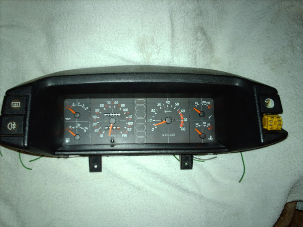

If you carefully look at the speedo, its got some lines between all of the guages, you literally swap them out, so in the case of the diesel you'd get rid of the guages on the right hand side which are the lights of doom & slot in the temp one thats fitted to some of the petrols as standard

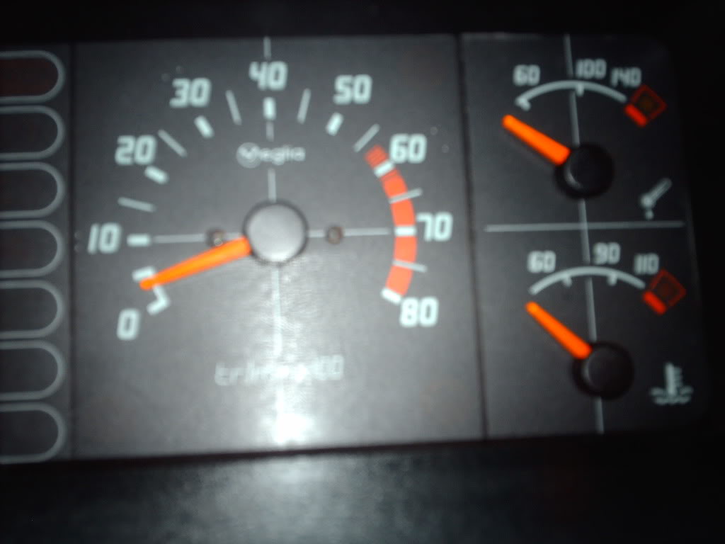

I think this one will work - the temperature gauge section on the right hand side should lift out and slot into your bx unit.

Steve, the one you've pointed out (On E-Bay) is from a Pug 205 TD which only has the temp gauge, get a set from a petrol Gti 8/16 Valver or 4x4 BX and you get the oil temperature gauge toosdelasal wrote:I think one will work - the temperature gauge section on the right hand side should lift out and slot into your bx unit.
That's why the Pugsters boy's are always after/on the look out for them like the ones I HAD from a GTi 8valve (Then you'll have the full set like Mat F)
Happy Gti 8/16 valve 4x4 Gauge hunting chaps!Defender110 wrote:I want one too!...in fact I want two too!

Finding the whole instrument pod is probably the easiest way to go Matthew. When you find the gauge get in touch with me cos I've already done the research to find the right 'sender'. Oil temp and water temp use the same sensor / sender but they have to have the right resistance at 100 degrees C or it aint gonna tell you if it's going to blow.

It's fitted to the sump, so you need a sump with the extra threaded hole to screw the sender into. Common to several XU engines, so your search isn't limited to BX sumps!
I'm puzzled by the statement that the oil and water temperature senders are the same, as the ones I've seen aren't - the oil temperature sender has a larger thread although the thermistor inside may well be identical...
