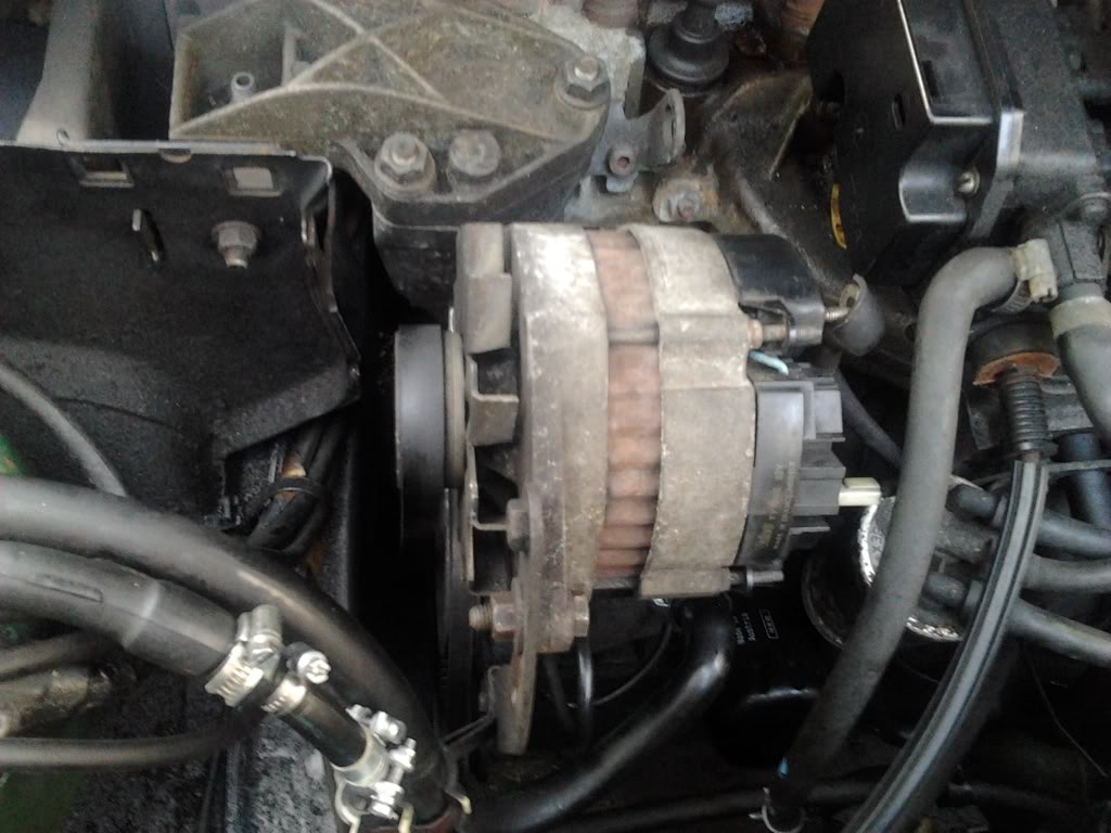

The alternator is easily accessible in the petrol BX's – it sits at the offside front of the engine above the HS pump, You can't miss it. It is held in place with a large pin nut at the side closest to the engine and by an adjustable nut/bolt arrangement on the front side where it is bolted to the mounting plate – a 'C' plate that also mounts the HS pump at the bottom.

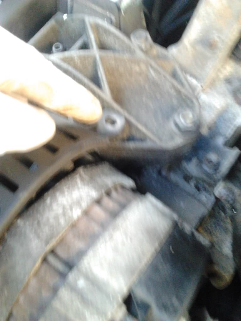

First task is to remove the belt shield – this stops you catching your clothes in the pulley and having your bonce clouted off the engine block as a result – it is fastened with two captive bolts:
exposed

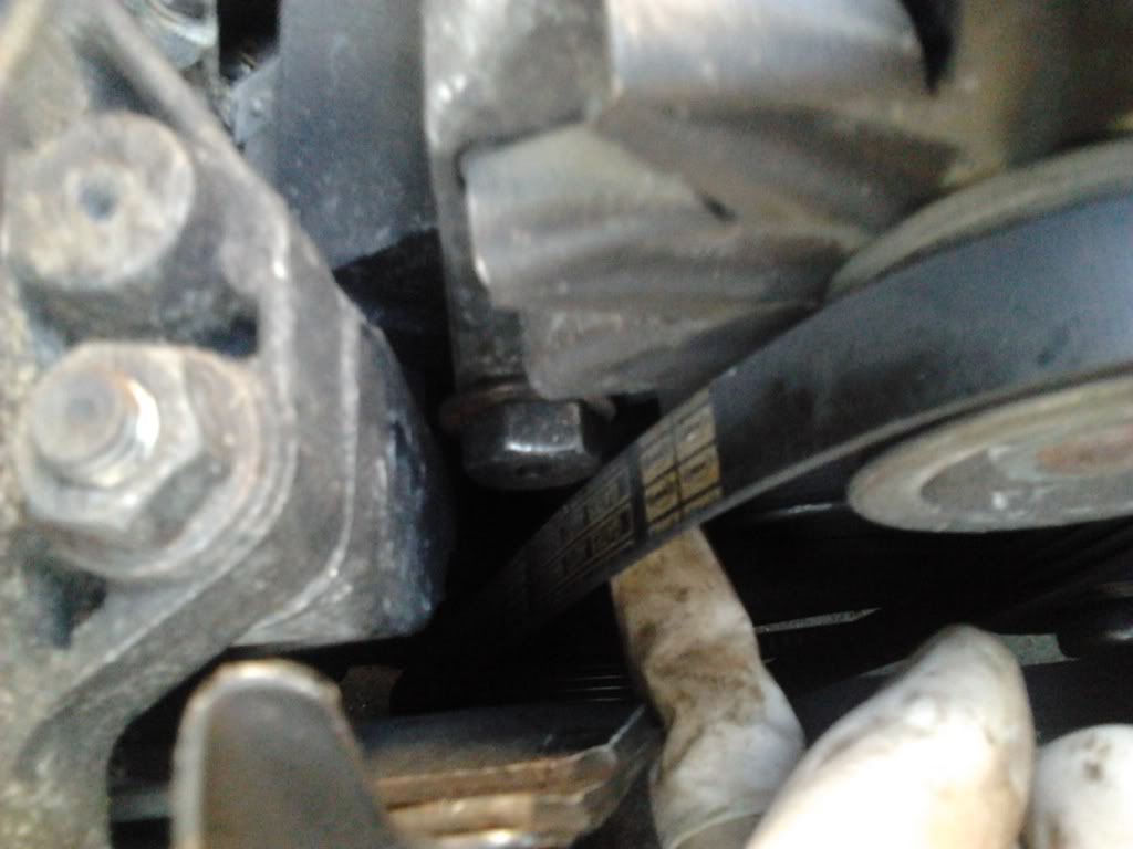

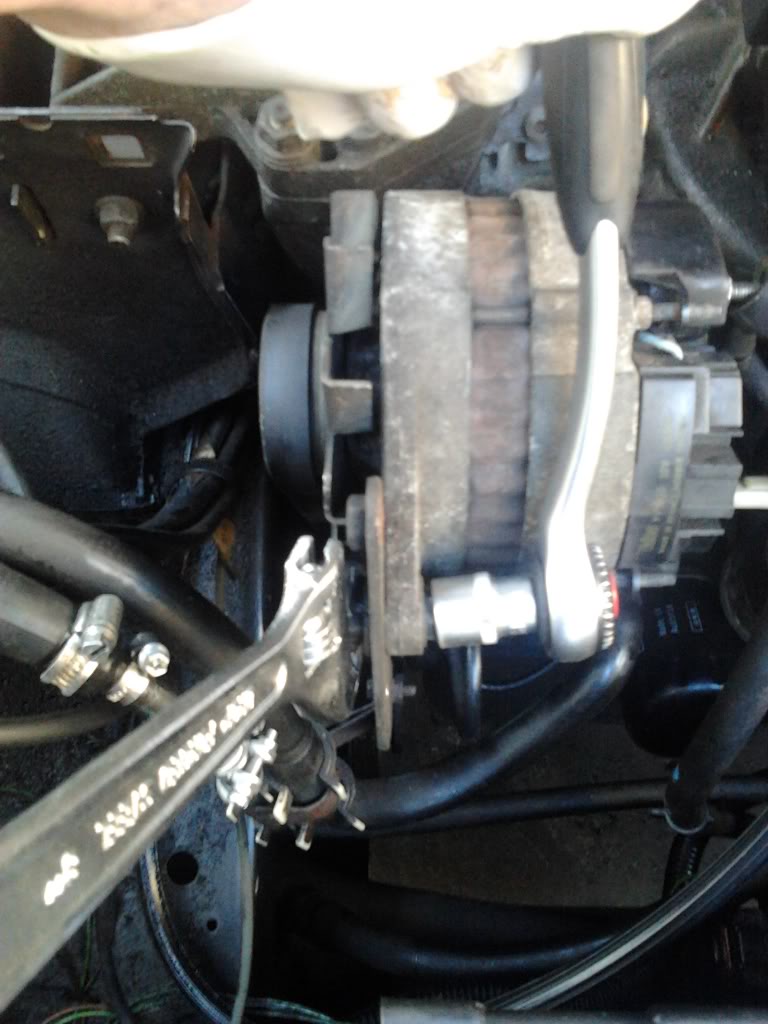

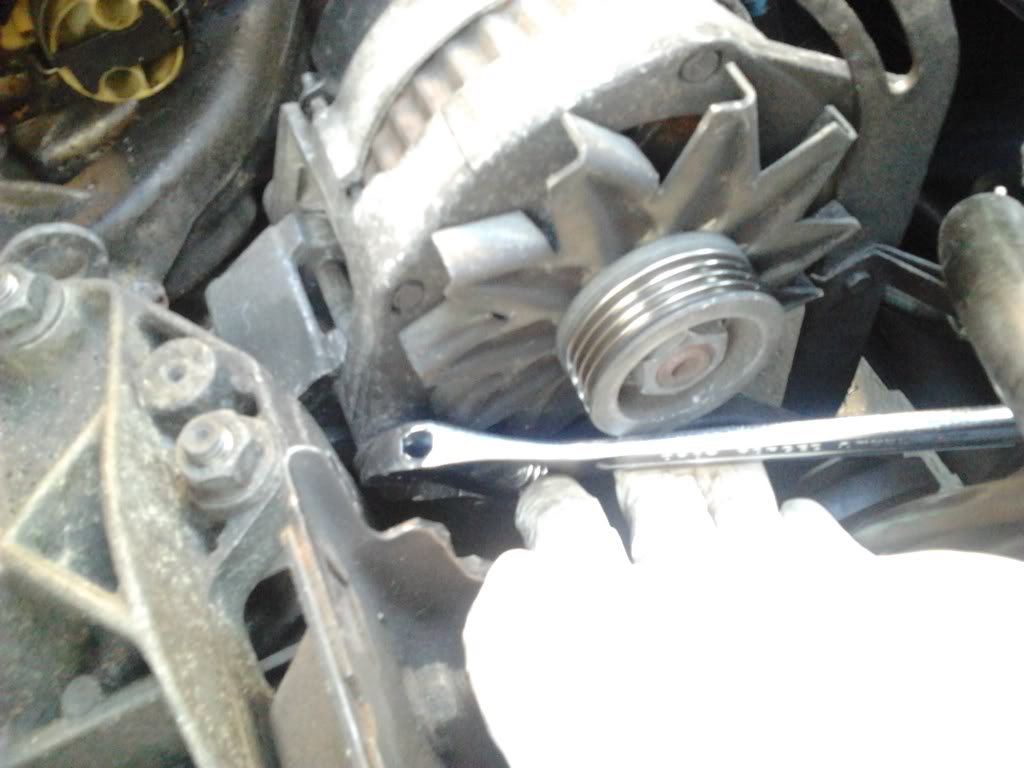

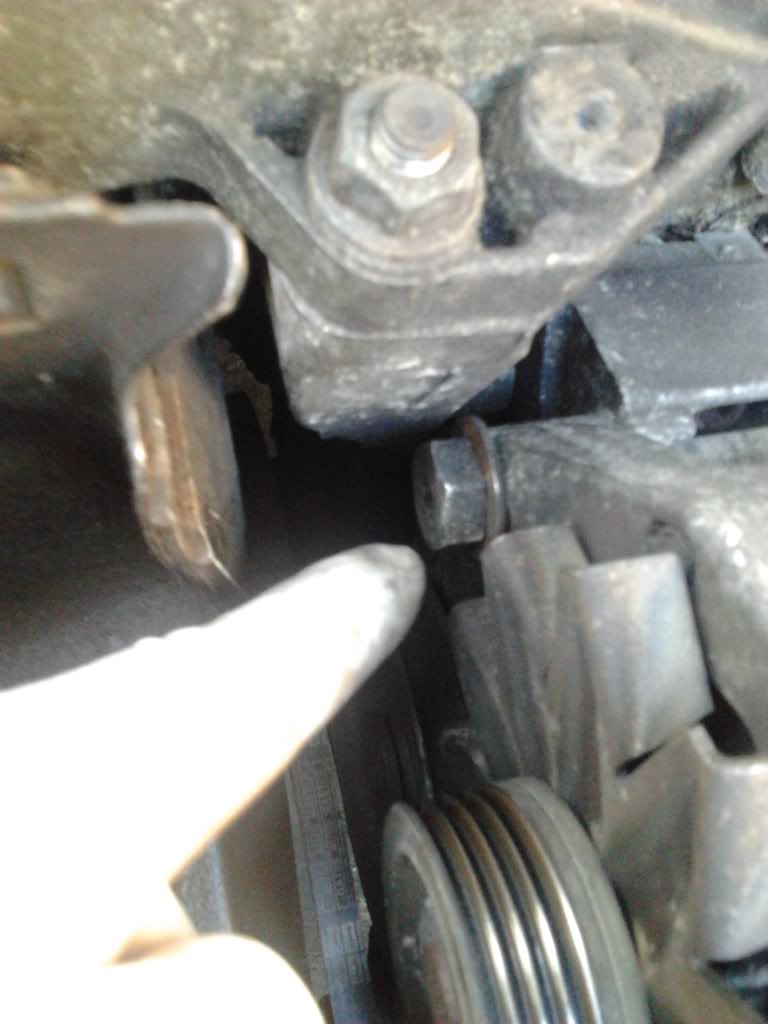

Next step is to loosen the mounting pin – is a pig to get to you'll need a spanner – 21mm so larger than most sets it is also in a very awkward position as the proximity of the engine mount frame means you can't get a socket on it and the position of the bolts means that there is only one angle of attack for getting a straight spanner in – the ideal tool is a doglegged round spanner. I don't have one of this size (every other flippin size – so I resorted to an adjustable spanner.)
The position of the mounting pin nut:
The angle of attack with the spanner:

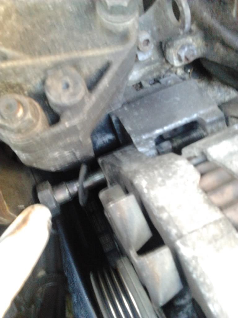

Once loose enough to use your fingers undo it and withdraw the pin as far back as it will go – this will free up the mount at the back of the alternator. Note that you will not be able to remove the pin completely due to the engine mount.
The mounting pin in withdrawn position

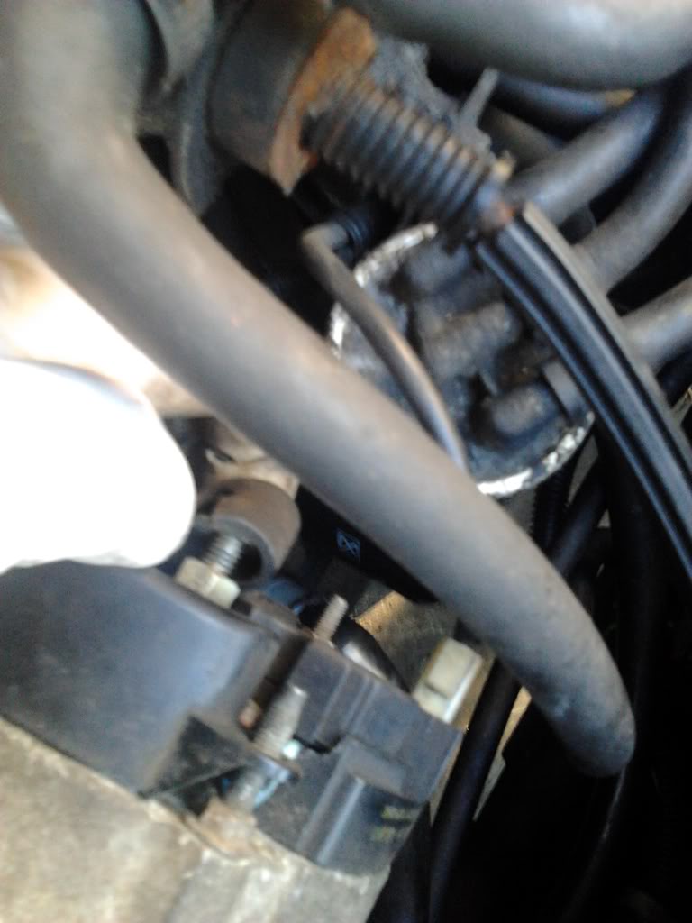

Position the alternator so that it is sitting as low as it can go and then unscrew the B+ nut and remove the spade connector in the back of the voltage regulator. Don't remove these earlier as the B+ is very tricky to get to due to the position of the ignition module and a coolant hose.

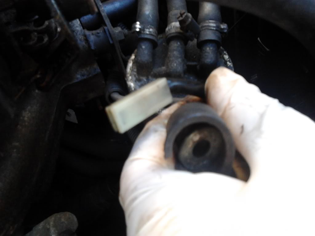

You will need to remove the spade connector and the B+ O ring connector which is too small for the larger alternator. Replace these with appropriate sized O rings – make sure your crimping is sound, ideally solder and wrap in heat shrink or insulation tape. A poor connection here can cause your charging system to fail – usually in the pissing rain on a February night so it is worth doing properly.
These need to be replaced with appropriate O rings
Give the O rings a good coating of Vaseline as you won't be able to reach them when attached to the alternator.

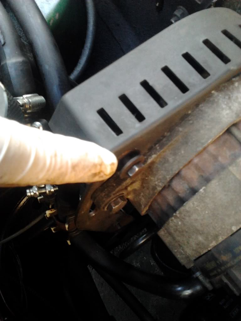

Refit the pulley cover – note that if you have a wider pulley fitted you will have to attach the cover by using a longer bolt to hold it in position to the off side side of the adjustable plate -
This picture shows how the cover is attached to the adjustable plate normally – if using a wider pulley the cover needs to be bolted here but on the OTHER side of the plate this ensures the cover will not rub on the pulley
you will be unable to attach this end of the cover as the hole will no longer align due to the slightly larger size of the alternator.
