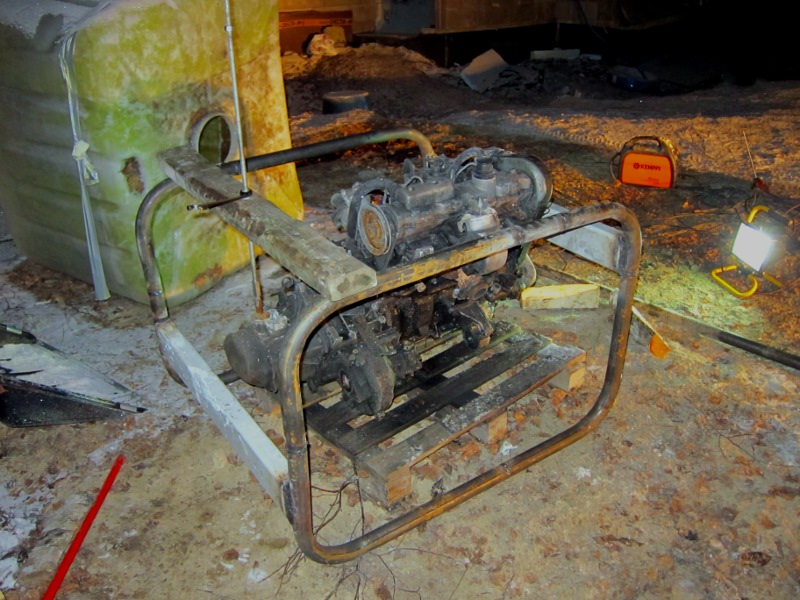

Well, there she goes:

I imagine that may be a touch "vocal"

Yes, I should think the exhaust back pressure will be a bit off as well...

Just fitting it first, it still lacks the cooling system, battery, exhaust etc. :wink:

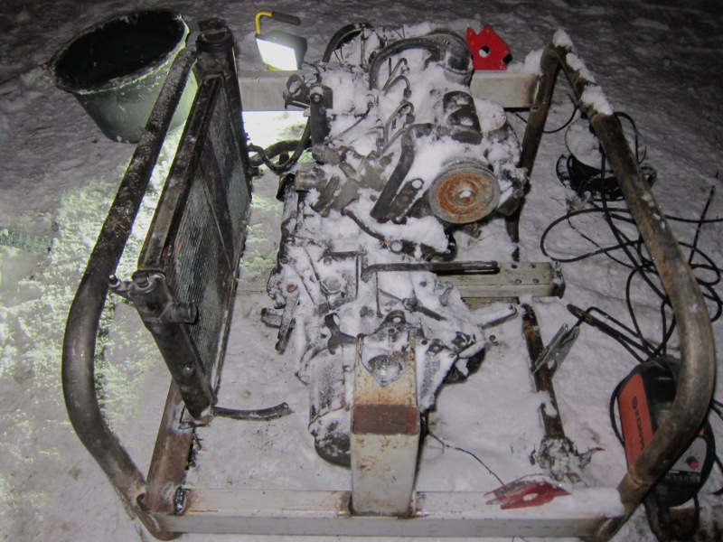

Proceeding steadily but slowly..

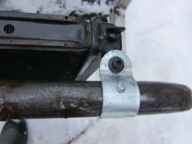

Any ideas how to elegantly fix the top of the radiator?
BX Van 1.9D -90 Gone.
BX Van 16S -90 For sale.
Brrr, that looks cold! Not sure how elegant you'd consider it, but you could weld a couple of tabs onto the top of the frame, extending over the pins on the radiator. Drill and tap the tabs (or weld on a nut) and screw down into the pins on the radiator.

I applied your idea with a slight modification:

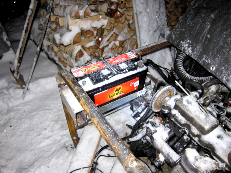

..battery rack...

Didn't know that you could buy a banner battery out your way, i've got one fitted to my txd.
