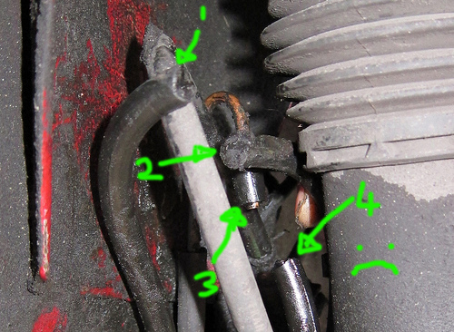

While looking at the nearside strut from the wheel arch end of things (with the wheel off), I spotted four(!) broken off ends of pipe, clearly all meant to have been attached to each other.

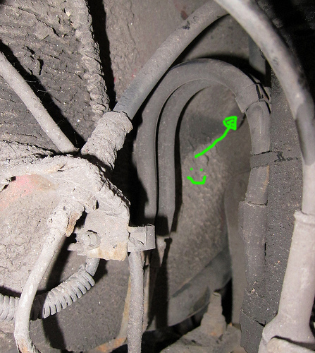

I include photographs of said pipes. One of them ("3" in the picture) looks like it has had a length of metal pipe patched in? Also a picture from the off side which is I assume what it should look like.
So, any thoughts on what to do. It doesn't look like the end of the world. Is it worth patching these, or new lengths?
I hadn't noticed any particular symptoms from the car, other than as I was taking the wheel off a few drops of LHM dribbled on to the floor.

The leakage return and breather hoses of the front struts have a tendency to crack, and if they are left unattended, the hydraulic system sucks in water and impurities (here, the worst being road salt). If you notice a broken hose and can't replace it immediately, putting in a pipe as has been done to yours is an OK system to postpone the change for a while, but if this temporary fix is left in permanently, it will eventually crack again as has apparently occured in your car.
Changing the hose is a minor job, and driving with the broken hoses will quickly contaminate the hydraulic system, so I would get the new part and replace it immediately, and then flush the hydraulic system. The contamination problem may be a bit less severe over there (I suppose they don't use the salt so much on the roads), but it's a problem nevertheless.

Yes these are just strutt return pipes that will leak LHM bypassed by your strutts. I have tried to repair better condition ones than these on several occasions only for them to fail again. I have come to the conclusion they are not repairable and simply must be replaced for long term reliability.

They are push fit in the other end, and attached to the strut with a steel collar in the other end.
Leak back hose # 95 622 818
You might also consider a new collar, if the old one is in bad shape.
Collar # 95 612 275 (or RP 96 127 591).
