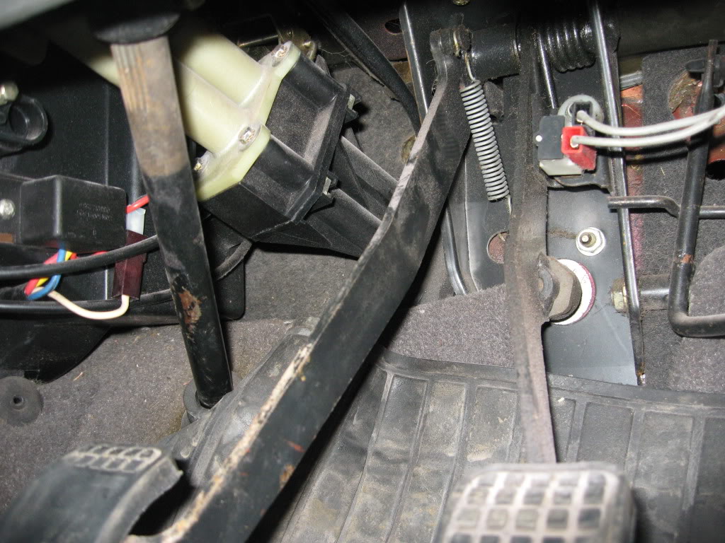

Managed to get a photo- hopefully its good enough so you can see waht an earth im gonig on about!
As you can hopefully see the spring attaches to both the bulkhead and the top of the clutch pedal . It’s about 10cm long (though I admit hard to measure in situ).
So could someone please tell me if it’s the same as mark 2s etc? lol…go on stick your heard underneath your mk 2 bx dashboard and have a peak! Without this spring being replaced I’m not sure how to go about getting it out of the garage- its got a lot worse so it’s very difficult to find the biting point, which combined with the carb issues makes it difficult to manoeuvre at slow speeds...such as backwards down a gently curving driveway...
If it is the same as mk 2s is it still available new? Obviously due to the nature of springs I’d like one new. Though I think I’ve found a few second hand sources…..

Go on then, it's the same as my MK2 TZD by torch light on a freezing cold night in my pyjamas.

As for what it does as far as i acn see it basically resests the clutch pedal to the normal position when you take your foot off. Or in my case very slooooooowly does this....
Anyone thanks very much for that
