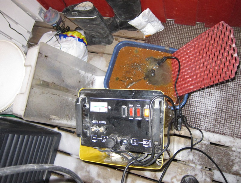

-17 C outside, but the water is almost scalding with 20 amps going through.

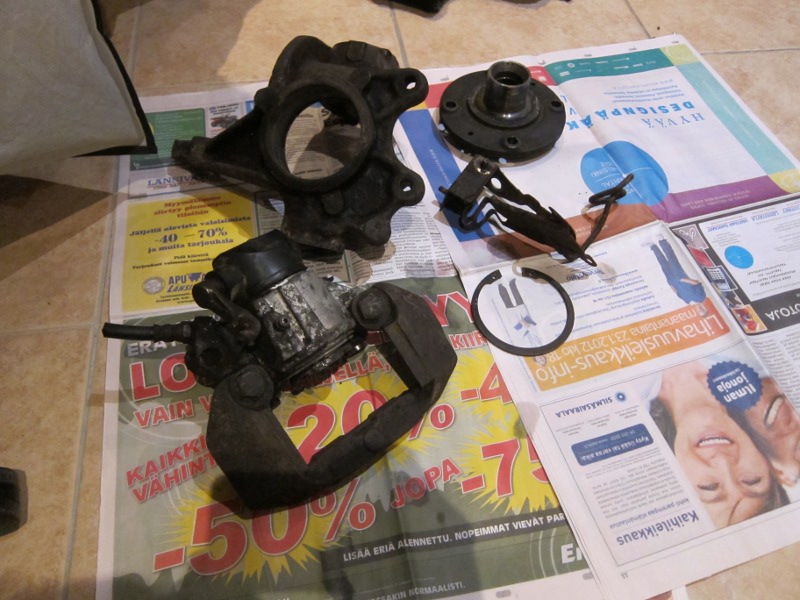

After process:
Next step: painting & installation of new bearings.

I don't think it would be possible to obtain a much better result by any method: all rust was boiled off, and all that was left was a gentle brushing to remove the loose deposits of de-rusted iron and the chips of paint that had had rust under it. In addition, the warm water helps to remove all other impurities such as dirt and grease. And all this while you just wait..

I don't think you can argue against that! Obviously a job to be done overnight whilst sleeping to stop you hovering over the pot like an expectant fatherrmattila wrote:I don't think it would be possible to obtain a much better result by any method: all rust was boiled off, and all that was left was a gentle brushing to remove the loose deposits of de-rusted iron and the chips of paint that had had rust under it. In addition, the warm water helps to remove all other impurities such as dirt and grease. And all this while you just wait..

Just a couple of handfuls of washing soda is enough to turn a bucket of water into a good electrolyte, and depending on the batch size, either the 24 V start booster or the welding inverter will make a good DC source. Due to the heavy hydrogen buildup the process must be done outdoors, but it's not a problem, since with 20 - 100 amps the water keeps hot even in winter (it's -23 C now and I've got another batch bubbling overnight).
