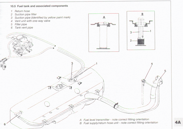

This help?

the reason I ask is that after looking at the diagram way2go posted and this picture.
it would seem that the garage may have plugged the origional feed pipe as it seems to be the right length to go to the fuel pump ( black rubber with yellow writing) whereas the other (fabric ) pipe seems long enough to reach the carb suggesting it might origionally have been the return pipe.
also on the diagram it says the suction ( input ) pipe should have a yellow paint mark and the plugged pipe has yellow writing or is that just coincidence

If your suspicion is correct then the feed (old return) pipe now would not be filtered from the tank. However IIRC there is a built-in filter in the SU pump so this would not be a major problem.
BUT, if you look at the diagram, the end of the return pipe is higher in the tank than the feed so your usable petrol volume will be less as there will be a considerable volume that you cannot therefore access.
