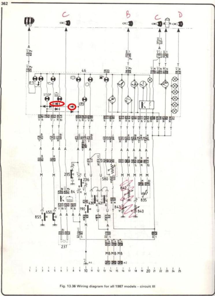

On the circuit diagram below:
-855 is the water temp switch which connects to the water temp light (aka "the red light of death") and also has a diode to pull on the STOP lamp
-237 is the water level sensor which connects to the water level light and also has a diode to pull on the STOP lamp.
-235 and 236 are LHM pressure and LHM level switches respectively, they both connect to the LHM light and there is a diode to pull on the STOP lamp
So far so good, but the oil warning circuitry was designed by someone who now works for the Taliban.
-650 is the oil pressure switch which connects to the oil pressure warning light and also has a diode to pull on the STOP lamp, however it also has two other diodes (which I've circled in red) that will also pull on the water level and the LHM warnings lights
i.e.
-if the water "red light of death" light comes on, the STOP lamp will also come on
-if the water level sensor light comes on, the STOP lamp will also come on
-if the LHM light comes on, the STOP lamp will also come on
-if the oil pressure light comes on, the STOP lamp and the water level light and the LHM light will all come on. IIRC the owners manual does not say this.
Sorry to be blunt, but ....
Put 2 litres of oil in your car now, otherwise your big ends will go, repeat, put 2 litres of oil in your car now, otherwise your big ends will go
And, get a new dipstick.
If anyone wants to check this out, pull the lead off the oil pressure switch (it's about 10cm above the oil filter) and use a wire to earth the lead. Then start the engine and most of the warning light will remain on. I think the reason they designed it this way was so the army didn't realise that the IED is in the big end shells.
