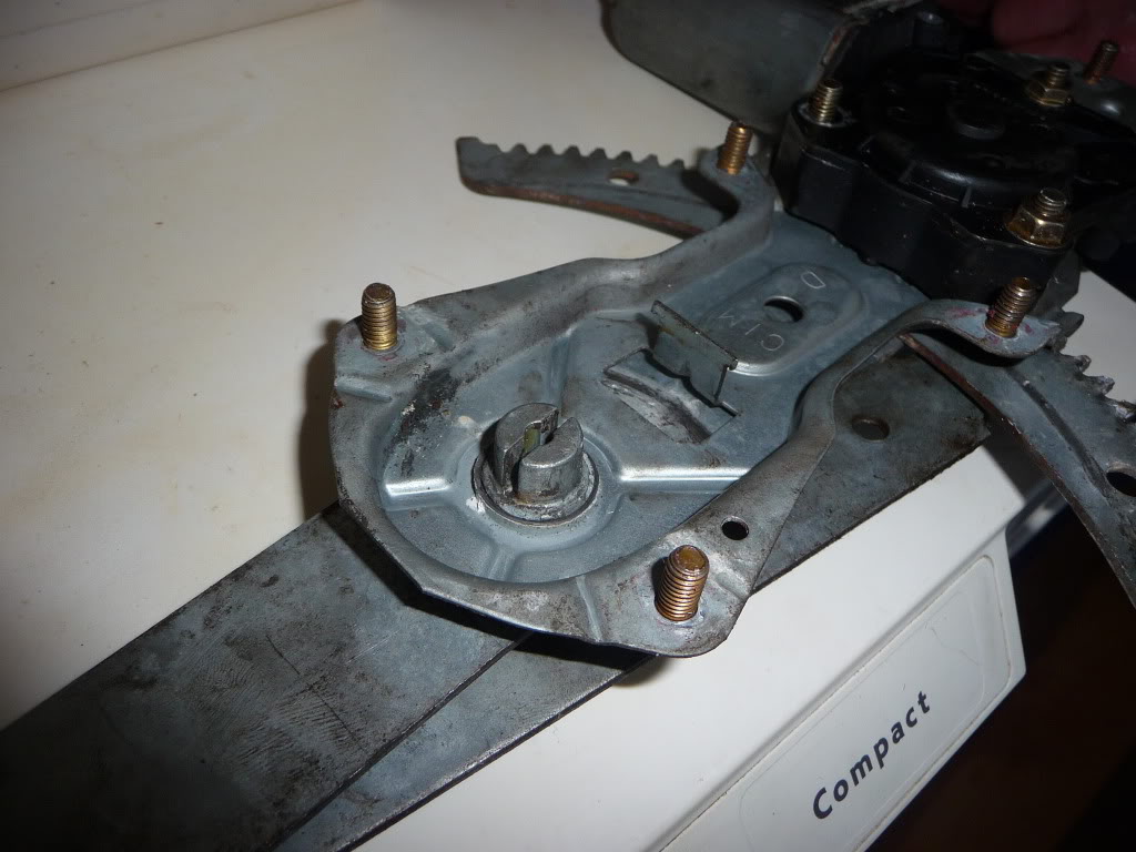

The drivers electric window wasnt working on the tzd i bought i took it apart earlier today and i think there is something missing to stop the mech coming apart?? heres a pic

http://www.ebay.co.uk/itm/CITROEN-BX-LH ... 5d2b35aa29
look at this carefully and you can see the big spring (like a clock spring) that also holds the pivot point together

THe frame work of the mech is not designed to come apart..it is factory "pressed" into place..this is what makes them impossible to repair if worn..When they are worn the window will go up and down but pretty much any where it chooses!!!Djr88 wrote:The drivers electric window wasnt working on the tzd i bought i took it apart earlier today and i think there is something missing to stop the mech coming apart?? heres a pic
And yes it does need the big clock spring.. if you get stuck i can send you one
