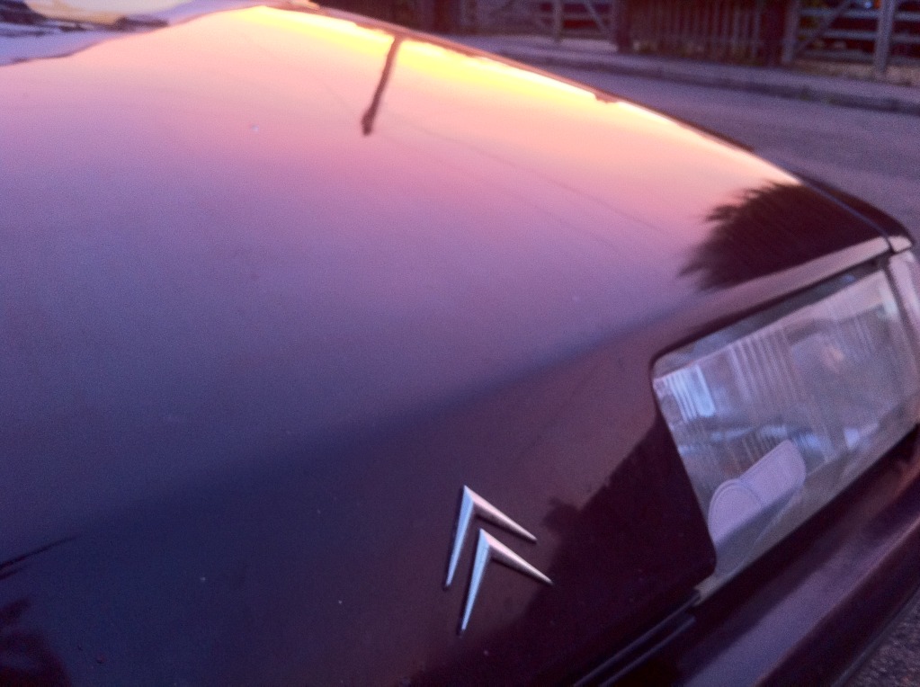

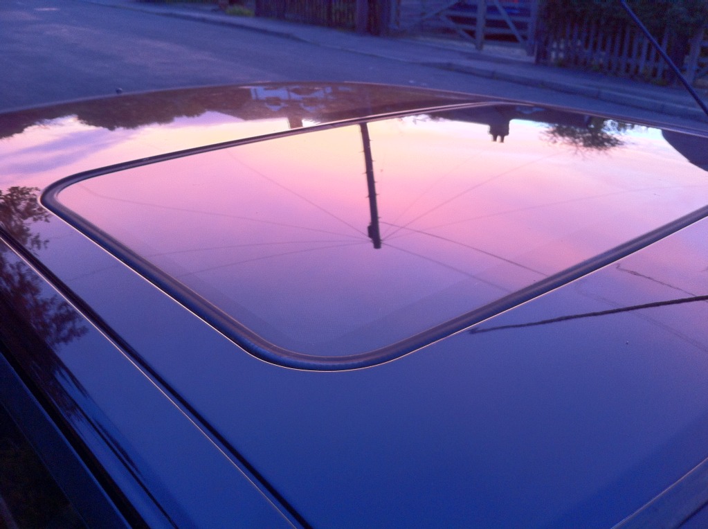

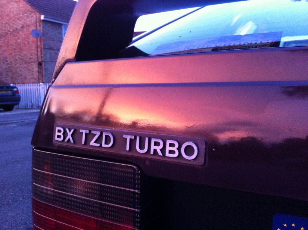

Just a few phone pics of my car after work today.
