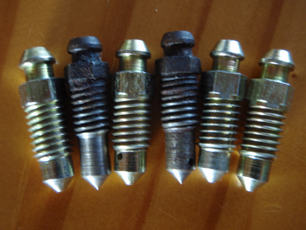

Re: Brake caliper bleeding nipples
Well after all the prevarication about them, the bloody things came out without so much as a single swear word being employed! I think 2 days of liberal WD40 spraying and a tap with a hammer on the calliper obviously helped. Went back to the motor factors as the belts i'd had on order came in and got the most similar nipples they had.
I know they look different, but the old nipples had thread protruding ou tof the caliper, as in they were too tall so these slightly shorter ones have just about enough thread. But they aren't quite as pointy so we'll see if they leak or not. No LHM came out when I removed these two from the rear callipers btw, but she has been on axle stands for a week or so.
I wonder if the fronts will be so easy?
