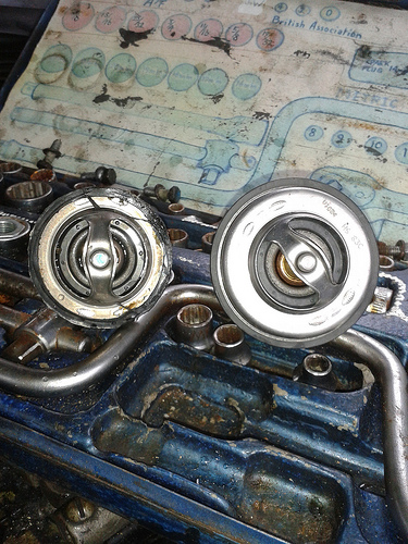

So I decided today was the day for a nice thermostat change as the seal has apparently decided to no longer seal.
I had my replacement all ready, but obviously it is hard to tell before taking the whole thing to pieces if it really is the right one or if Eurocarparts are just idiots. Sadly, it may be closer to the latter.
As you can see, different sizes! (The old one is on the left). The seal was pretty crusty and has a small hole, which is probably where the leak is from, as I've rotated the seal on reassembly and the drip is now seemingly at that point. So, would anyone have one of these knocking about? Or a source for the correct 'stat+seal?

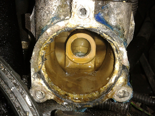

Yum, lovely colour in there.

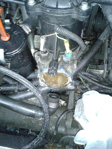

Looks like a sewer pipe or something!

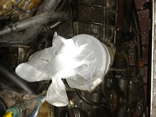

Isn't this was latex gloves were designed for?

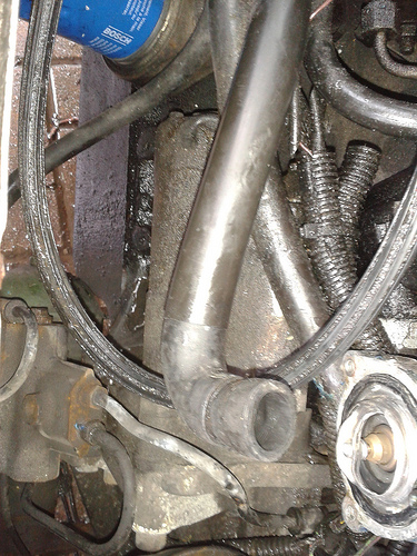

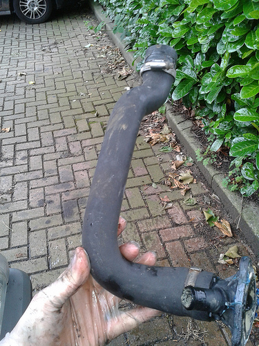

This hose was nice and soft
2012-07-03 13.44.24 by Wooscary, on Flickr
But this one is starting to disintegrate nicely. Does anyone have one of these or know a source? It's the slightly smaller lower hose from the 'stat housing.

Is that the hose which goes to the oil cooler sandwich plate? If so I managed to get one mail order for around £20 earlier this year. Let me know the seal size and I'll have a rummage if you like, but while you have the 'stat out it might be best to take it to a local factors (if you are mobile!) and match it up. It looks like they have sent you the early type so I would get a refund from Euro Crap Parts - you shouldn't be out of pocket for their mistake.

the new stat you have there is inded the early one with the alloy housing. You need a bog standard stat with seal. If you ask for a stat for a diesel Xantia or ZX for that matter you'll get the right size stat
