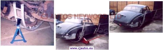

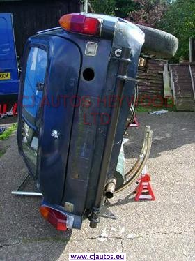

I've also seen a variety of tilters, one of which you could perhaps build yourself. One consists of a pair of A frames that attach to either subframe or bumper mounts at each end of the car, with the car high enough to be rotated spit like in the middle. Another is a frame that bolts to the hubs on one side that allows the car to be rolled sideways.

Mounting the frame to the hubs would be my choice, but not suitable for this particular case, since I'll have to remove the rear subframe in order to gain access to the area in need of welding. Bumper mounts, on the other hand, seem a little thin to carry the entire car.

You could actually buy a frame especially made for a Morris Minor and bolt it to the wheel hubs and then roll the car to any angle you required.
Probably could get one made up for a BX. Wonder if they still make these frames?

Making a frame like that would be trivial:Mothman wrote:You could actually buy a frame especially made for a Morris Minor and bolt it to the wheel hubs and then roll the car to any angle you required.
The problem is where to attach it if you want to remove the rear subframe. Welding it to rear door rear frame could perhaps be one possibility.
