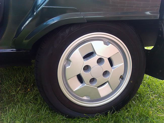

Here's one of the speedlines I did. I should really have wet n' dry'd the paint back before lacquering for a better finish - I'll know next time!
Just to do the rims you could do it yourself for 20 quid; file down the kerb dinks as far as you can without compromising the wheel, fill the rest with P38, mask off the rest of the wheel, etch prime, paint, 2pack lacquer (with a mask in the open air or you'll die of cyanide poisoning - not good) and polish; once it's all cured (and there'll be LOTS of sanding and finishing involved in that lot if you want a really pucker job). Bingo! If you want a hand Tim and want to save a few bob let me know.
