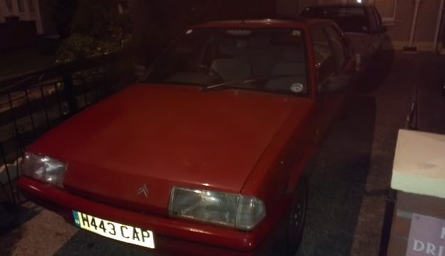

Red Baron on the road

Great! Now get polishing lol!
