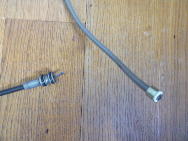

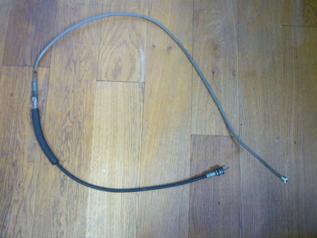

I am attempting to send in a complete speedo cable to "Speedy Cables". therfore I had my old cable removed for this reason, but now it is incomplete (see pictures below). I believe only a complete cable would be good as a sample to have a new one made.
Mine has the end bit missing and the inside bit of the upper cable (don't ask the mechanic just gave it to me like this.

here my incomplete cable photos:

I don't think my mechanic (usually very trusted) got the reason why I wanted the cable out. He only took out the top bit and the end bit is still missing. He told me that the bottom bit is ok but really as mine is an automatic I should have that one too.
On my photo I just added the spare one I got from someone some time ago, but now I think I should get the original off my car. I have seen the top end of it but I don't know how to get it out.
