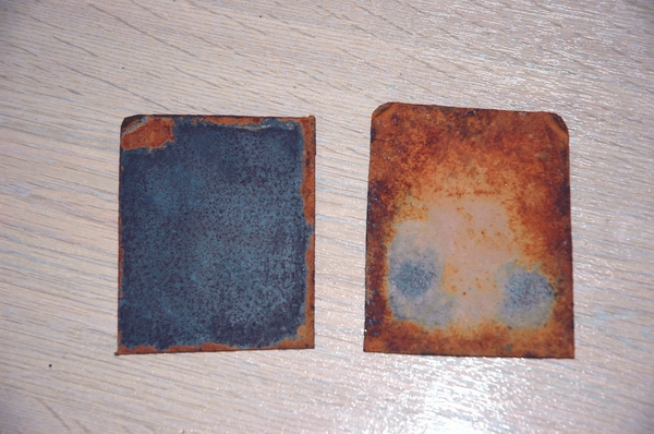

It's my hope that engine oil will seep between the seams better than a waxy product, and displace moisture. I seems to last for a couple of months wet weather use in wheel arches before the water stops beading up. One problem with the BX is the stone chip coating, which although lasts pretty well, also allows rust to creep underneath unnoticed. I think that with constant flexing of the shell, it eventually cracks at the seams and allows moisture in.

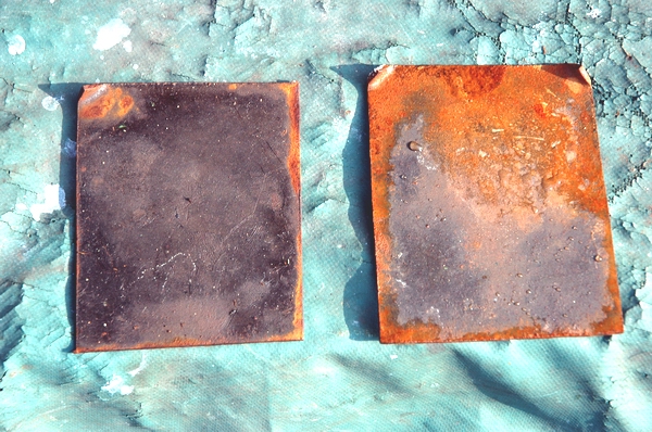

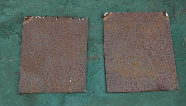

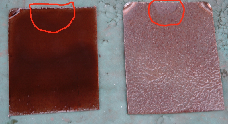

Post number 27 in this thread has the start of a 6 week comparison test between Waxoyl and Dynax S50, but in a nutshell here are a few pictures (Waxoyl on the right).
Sorry, we're diverging from the topic of 'where to apply it' to 'which is best?'
