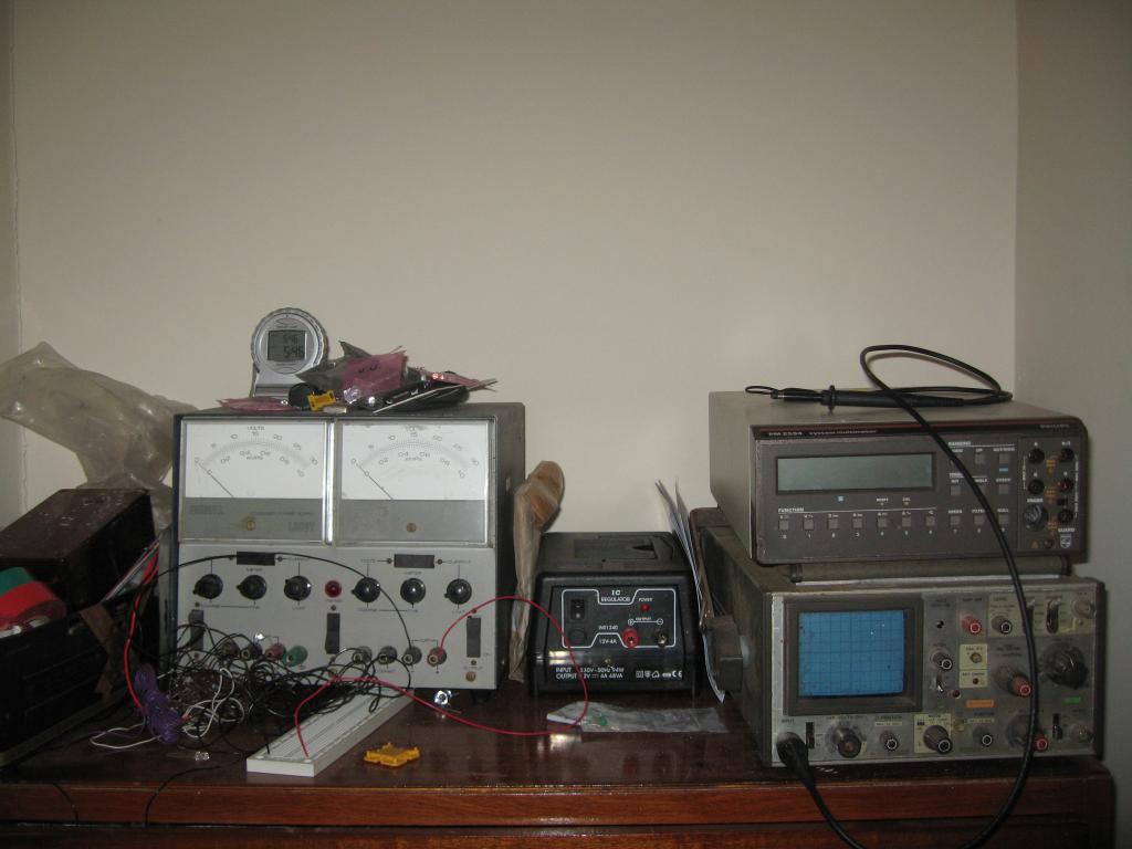

And just because I found the pic the other day
2002 C5 HDi SX estate
- Posts: 7330
Re: Instrument pods - Peugeot
The diesel rev counter will be also calibrated for one pulse every revolution, rather than two pulses every revolution for a (4 cylinder single coil) petrol engine.

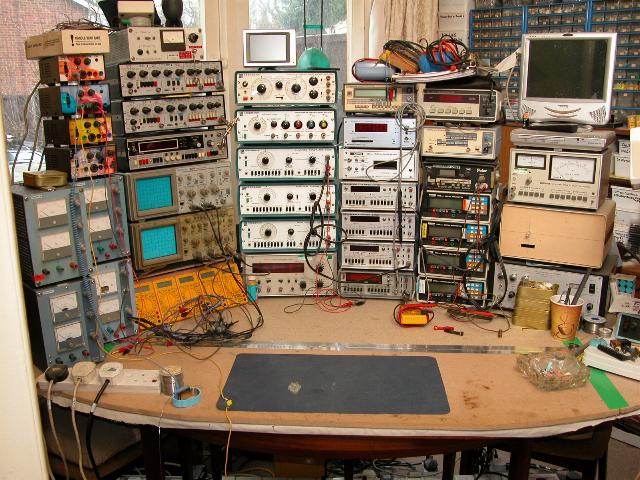

at your workbench though - puts mine to shame:

I'm sure there are other areas where you have much more kit than me
though mine is a bit OTT but I like it that way. There's a complete mix there - quite a lot of older kit bought on eBay for not a lot, there are 4 CB PSUs top left which are modified with extra variable voltage and current regulators and the main output taken to our favourite DIN 4165 socket. The cheapest kit - probably the yellow 'very basic' meters - one on the bench and 5 under the 'scopes - something like £2.78 in 10 off quantity from CPC - at that price I thought it right to buy 10
The most expensive is the lower of the 2 oscilloscopes which cost me a grand in 1990 - its front panel darkened by years of use in a smokey atmosphere
One pain is mains distribution - the pic doesn't show the rack to the right which has more kit on it including an old spectrum analyser and a Melford monochrome tv monitor - under the workbench there are some 40 13A sockets and a yellow 110v transformer for a couple of the instruments and American sockets
This lot has been moved now - the oval 'chipboard bench' is protection for the G Plan dining room table which I wanted to have back to eat my dinner off. The solartron microvoltmeters (the 4 lowest instruments in the fifth stack from the left) have been put aside for another project because they have IEEE bus connectors and are destined to be part of a computer controlled setup along with a Racal nanosecond counter and some analysers.
