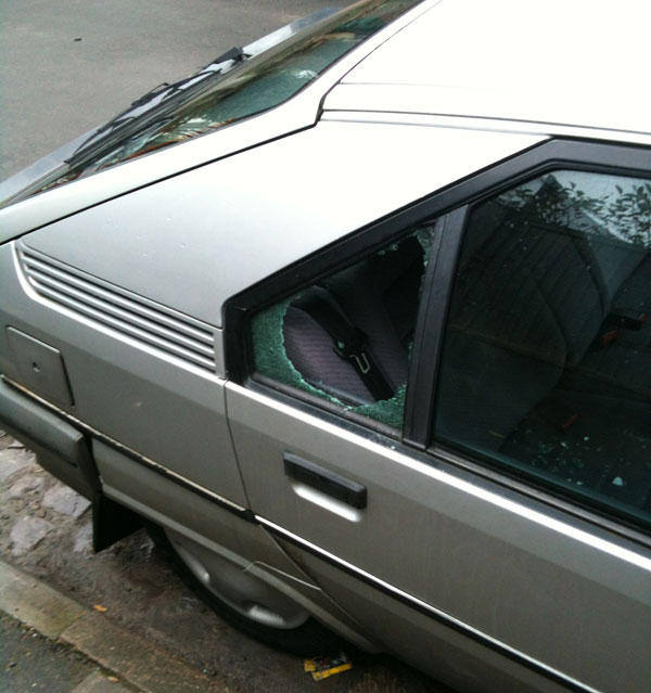

Sadly my 1992 BX19 TGD "Maurice" was broken into last night while visiting friends in Bristol. The thief smashed the fixed rear glass on the driver's side and then reached in and unlocked the car by pulling up the lock 'stalk'.
Has anyone got any recommendations on where to source a new piece of glass? And is this something that can be fitted as a DIY job or is it best left to a professional?

welcome, and sorry to hear of your break in, where abouts in bristol was this?
More over, are you still in Bristol?
It's a fairly stratforward DIY job, and glazing is held in stock by several people here in Brizzle, and I would assume all over the country.
I could sort you a replacement if you're still about this part of the world?
Haven't ever considered door lockstalks before, but it would be easy enough to have a trigger button mounted wherever you want it to fire the CL really..

They are a fiddly job but can be done at home, Ive recently done both on mine when I changed the doors.

Really sorry to hear about your break in Phil and welcome to the forum: no need to lurk, we're all lovely!
I have a couple of those quarter-light windows if you get stuck, although they're an absolute pig to get in and out (unless there's a special 'knack' that I haven't discovered?! )

Looks like you've had an incredibly thoughtful burglar. Smashing the smallest window, and thus the easiest to cover over. And choosing the window rather than peeling the door or punching the lock out.
I wouldn't over think the break in, the BX is a very easy target these days. The only real deterant is not to leave anything in the car, regardless of what value it might have. To deter someone stealing the whole car i also wrap a rather large chain around the steering wheel and tuck the ends under the seat. The alarm and immobiliser probably wont put a would be thief off if there is something they can grab quickly.

Welcome along! Probably the neatest solution would be to use an extra rear electric window switch in the centre console, with one direction for lock, and the other for unlock. The central locking module is under the console anyway so easy to splice into.
Connect one of the common terminals on the switch to earth as the central locking module requires a negative trigger. Then press the switch in one direction and connect one of the terminals which becomes earthed to terminal 5 on the locking module. That's your unlocking sorted. If you want locking from the same switch, press it in the other direction and repeat the process connecting one of the other terminals to terminal 7 on the locking module.
I think you'd need to cut down the door pins yourself, but probably won't do much to deter a thief I'm tempted to do the mod myself though, as I think it would look rather neat.

Excellent, this sounds exactly the sort of thing I was aiming for. Thanks for the heads up on the location of the central locking module too, good to know. The rear electric window switch you mentioned, is that part number 95495141?
I'm on the case trying to source a spare set of these in grey so I can have a go at cutting them down while keeping the originals just in case. I think these are part number 96092909TR? My local Citroen dealer failed to source these today (along with the door quarter glass) when I called in.mat_fenwick wrote:I think you'd need to cut down the door pins yourself, but probably won't do much to deter a thief I'm tempted to do the mod myself though, as I think it would look rather neat.

95495141 is correct for the switch, but not certain on the door pins. It would be worth posting a Wanted advert on the forum for the glass, switch and pins as someone may have a spares car you can have parts from. I have the other side window glass spare
