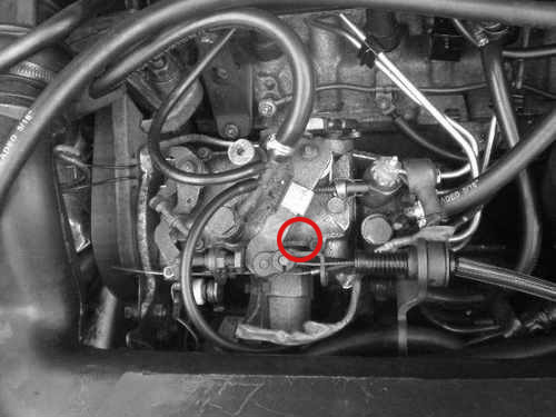

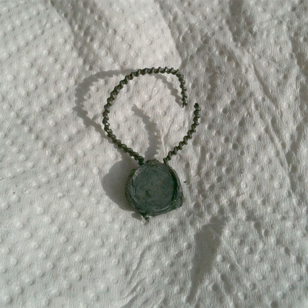

Just had a couple of minutes at lunch time to stick my head under the bonnet again. I noticed this piece had come adrift:
It was lodged in one of the small recesses at the front of the pump (photo robbed off the internet and subsequently circled):
Out of interest, what do these things do?
1992 BX19 TGD (aka Maurice), N/A diesel, silver with Zenith trim.
- Posts: 5917
Re: Strange revs behaviour - with video
It is a lead seal that is fitted at the factory to stop the factory settings being tampered with. If this was removed a warranty claim would be void.
- Posts: 199
- Joined: Wed Jun 10, 2009 12:30 pm
It was probably attached to the engine max speed adjustment screw. You can see it attached on the image. Above and to the right of your red circle. Going back to the anti stall adjustment. To set properly you need a set of feeler guages and a 3mm allen key or piece of wire/rod of the same thickness. The procedure is explained in the haynes manual.
