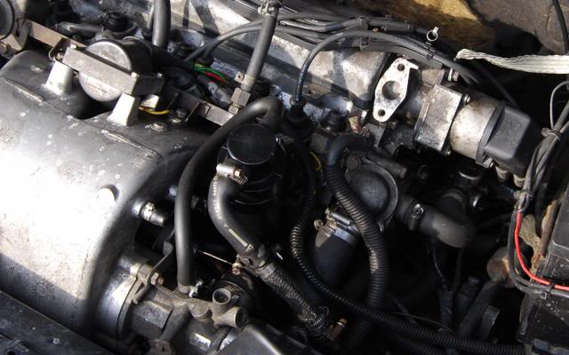

This is the pic of my dissy area
For sure it is a dissy, there is a screw missing and I was able to manoeuvre it enough with the engine running to feel the rotor tapping on the inside of the cap!

Changing the subject slightly. I thought only Peugeot 205's had that type inlet manifold. Solid block looking type as opposed to the four individual pipe looking one. Learn something new everyday

ghaddon1701 wrote:Changing the subject slightly. I thought only Peugeot 205's had that type inlet manifold. Solid block looking type as opposed to the four individual pipe looking one. Learn something new everyday
i've seen that before. I wonder if it's a 1.6 litre as fitted to the Visa GTi and Pug 205 1.6 GTi. Does anyone know if there was a BX 1.6 GTi on the continent?
Wikipedia says: "There was also a special export model, the BX16 GTi, using the 113 PS (83 kW) XU5JA engine from the Peugeot 205 GTi 1.6. Top speed was 194 km/h."
