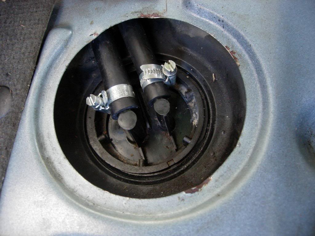

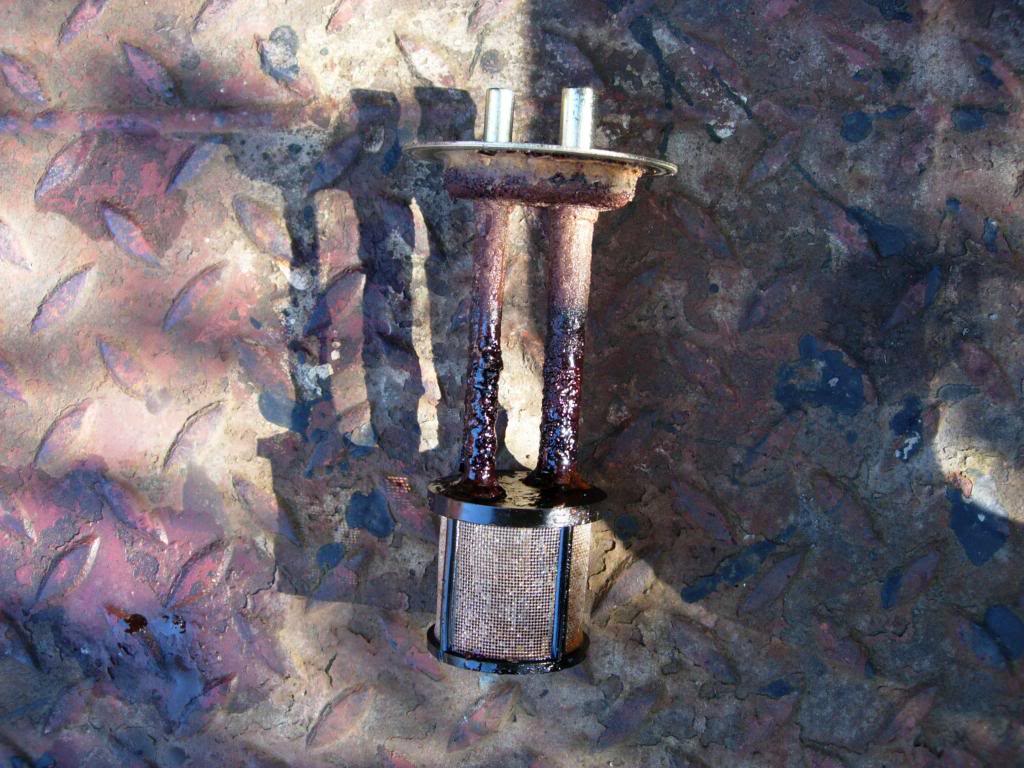

Managed to change the 2 metal fuel pipes, the fix went very smoothly, easier than i expected but when all started up, fuel leaking like mad from where it was before.
Decided to remove the rubber pipes and found a big split in one and a lot of cracks on the other. Quick trip to local motor factors and 2 new ones were aquired. However, Mollie being a MK 1, there is a different set up in that the fuel delivery sender has 2 metal pipes sticking straight up as opposed to the L shaped plastic ones on a MK 2. This means to fit as originally intended you need rubber pipes kinked at the end. Bend them and the pipe will collapse causing problems. It was decided to remove and fit the one from the scrappers tank. Whipped out the original and found to our surprise that it was corroded almost to the point of failure and covered in brown gunge!! Obviously there had been condensation inside the fuel tank causing the rust and i shudder to think about the quality of the diesel inside. The change over to the MK 2 system was an easy job, took the forum advice of keeping all tied up with bailer twine for an easy pull theough, worked a treat.
She now has her own fuel supply but at the moment is running very rough so i think that the fuel filter may be full of this gloopy brown stuff so thats the next job. Then i will empty the tank. Any ideas as how to clean it out other than removing it, a route i dont really want to go down?
It does go to show though that if you buy a MK 1 or any BX thats been standing a long time, its well worth checking out the fuel tank.

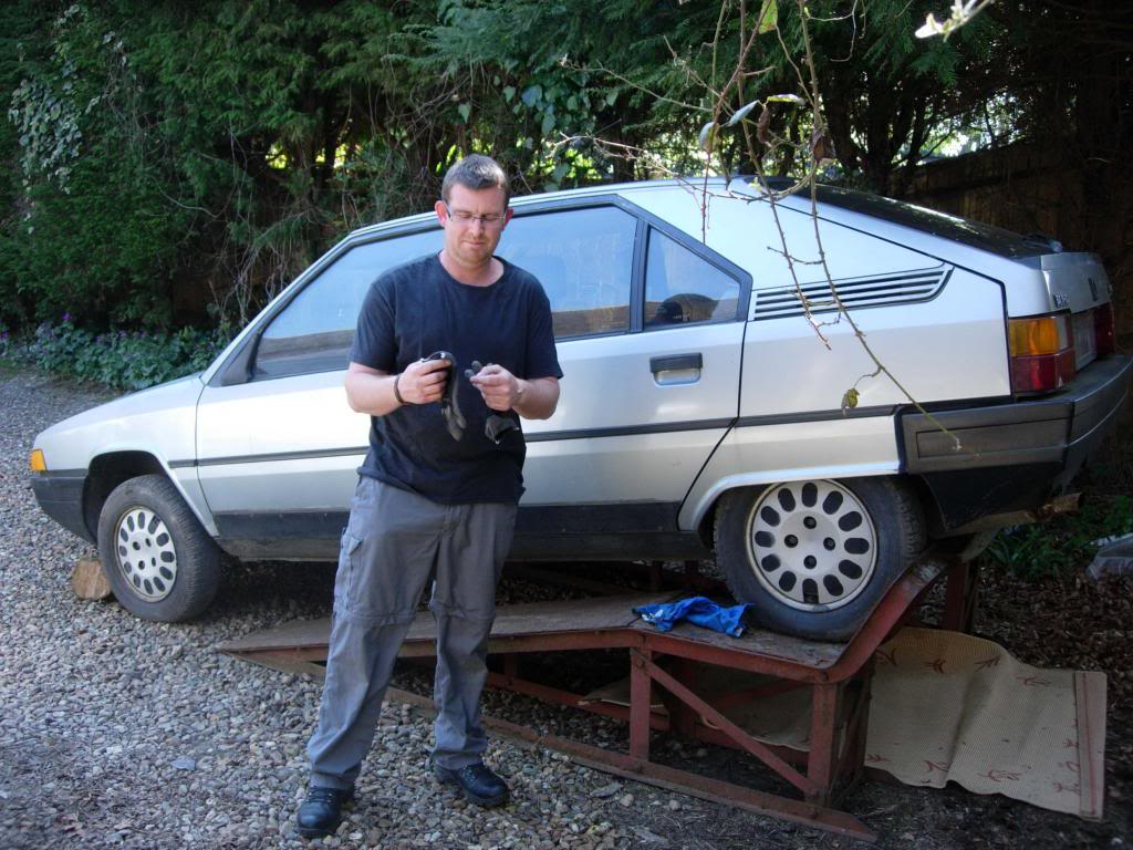

Mollie, about to be operated on!
A simple mate who was helping me.

Then replaced the BX19RD badge on Gloria, a bit battered it had become. Removed the complete fuel filter and primer head on Mollie and yes it was well crudded up. Gave it all a damned good soak in petrol and a good clean but even after leaving it in the sun to dry, decided it wasnt worth refitting so managed to find 2 new Lucas 7111/796 filter units on feebay for a tenner. Will be draining out as much of the fuel as i can tomorrow. This will give me a chance to inspect and clean the fuel sender unit, i expect it too is well gunged up although still seems to work ok.
