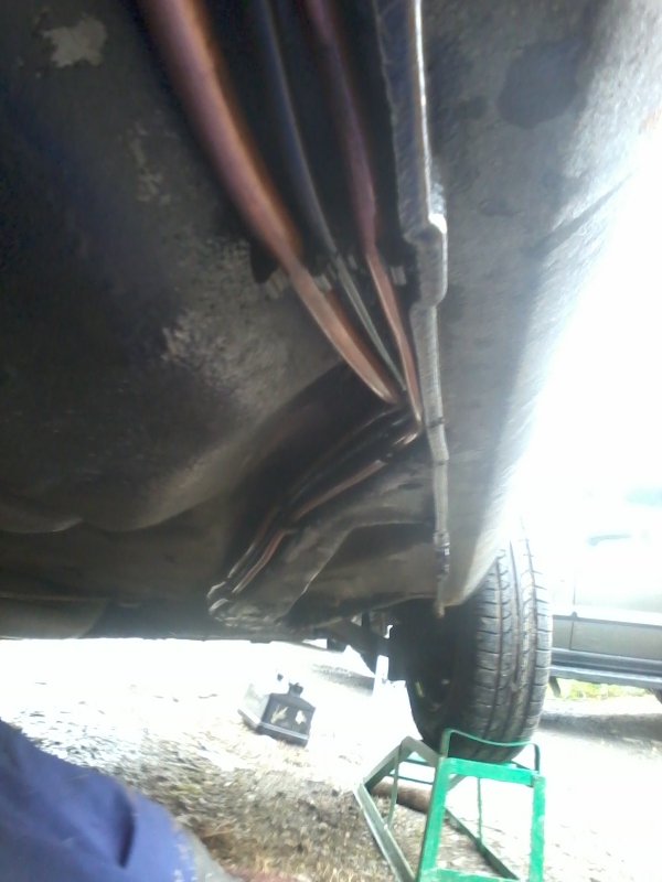

Re: diesel leak corroded fuel pipe
No the main fuel pipes aren't clipped to the fuel tank they just enter flexible fuel hoses at each end, just pushed in. I replaced my main steel pipes with a piece of nylon air pipe/fuel tubing as used in more modern cars which perfectly replaces the steel pipes and will never rust or rot. When you replace them if you have the auxillary tank set up this needs to be empty before you pull the pipe out or the contents will gravity feed out everywhere.
- Posts: 7330
Or (as KevR will probably mention!) you can use copper plumbing pipe - 8 mm and 10 mm. I had some left over from installing central heating so it was a no brainer, but if you had to buy a 25 m reel of each it'd be cheaper to buy the pre-formed steel pipes.

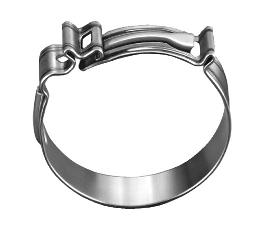

- Posts: 7330
I was meaning these type of clips:
but it was several years ago that I saw them so I'm wondering if I was mistaken. Certainly the more recent ones I've done have either had jubilee clips or the clips below you mentioned.

- Posts: 7279
- Location: RCoBerkshire
No you weren't mistaken, I had to cut those off the engine end of the pipes when I replaced the rubber pipes.mat_fenwick wrote: but it was several years ago that I saw them so I'm wondering if I was mistaken. Certainly the more recent ones I've done have either had jubilee clips or the clips you mentioned.
TBH I don't think jubilee clips are right for the job as it takes a few re-tightens in settlement before it seals properly. This is particularly so on the small bore jubilee clips as the screw saddle doesn't allow for complete circularity.
Maybe seen to be worse on the GTi on fitting to the rail as it is under pressure. I had a similar problem where it fits the metal fuel pipe too. (Note to self: must get new clips to go with new pipes waiting to be fitted!
citronut
- Posts: 2781
- Location: EAST SUSSEX UK
yes Mat i know the disposable type you mean, but i dont remember seeing them at the tank end of the fuel lines,
like you i might/could be mistaken or its another senior moment (bus pass moment )
From memory there were some orrible clip things of some description that i had to remove & i replaced them with some jubillee clips instead, no problems since & can easily get them undone etc...
- Posts: 7330
For fuel pipes I use these for that reason:Way2go wrote:This is particularly so on the small bore jubilee clips as the screw saddle doesn't allow for complete circularity.
Although having said that, the ones with jubilee clips weren't leaking. They could potentially be a source of air leaks getting into the fuel of diesel vehicles though.
