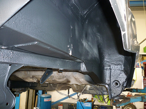

In the news today, yet more indignity as we look up a lady's skirt and see some silver spray paint has found its way on to her bottom. Looks like Hammerite to me but I gather this is some other zinc-based stuff which will dissuade further tinworm infestation. Further blushes will be likely when Mr Moss starts to add stoneguard, but from this point forward she's effectively covered up.
NS rear wheel arch zinc painted
OS rear wheel arch
Rear view
