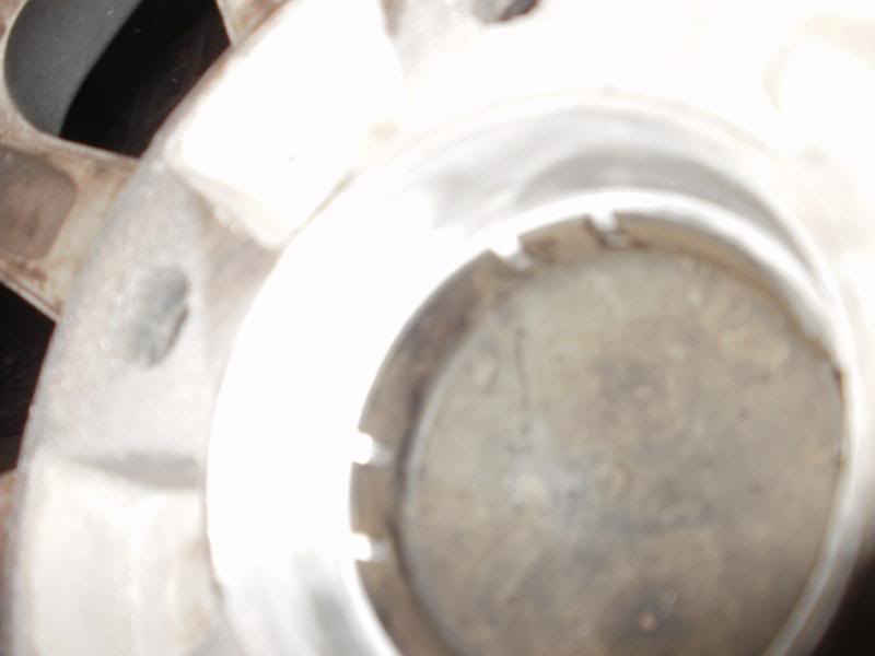

yay , my flapwheel is my new bestest friend,
we have spent some intimate moments together this weekend opening the bores ( well removing a lip really ,
for some reason volvo put a 5 mm wide by 1mm deep lip around the back edge of these rims,
removing that has opened the bore up to about the right amount and I have a nice smooth bore to fit my hubs now

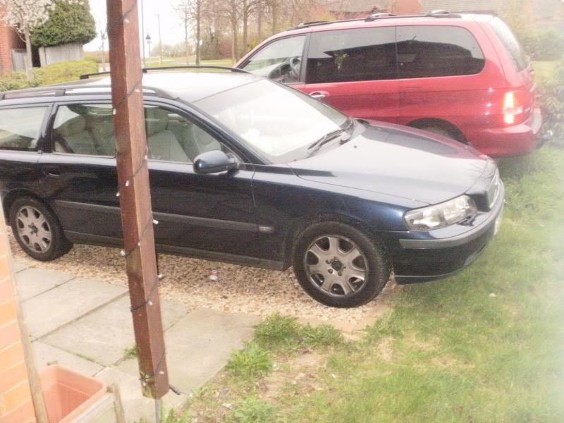

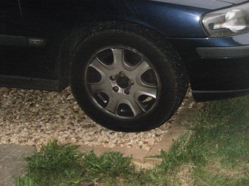

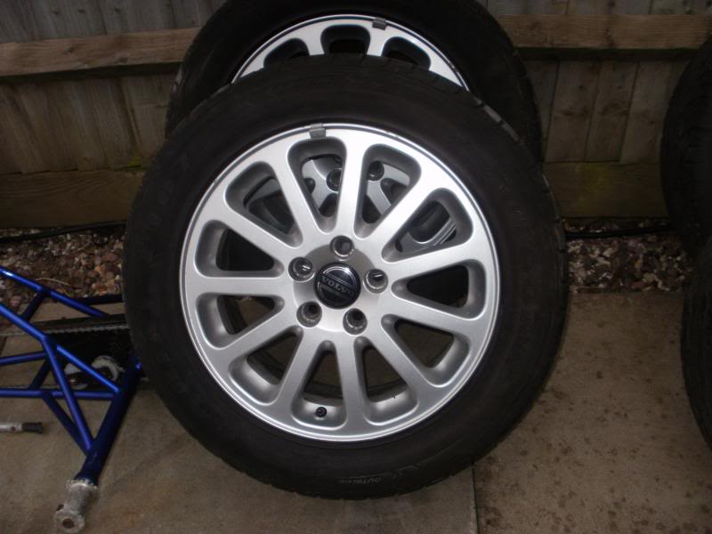

the reason for all this
one v70
ugly rims
nice rims and tyres for £120.00
but they were for an s40 so needed the centre bore opening up
