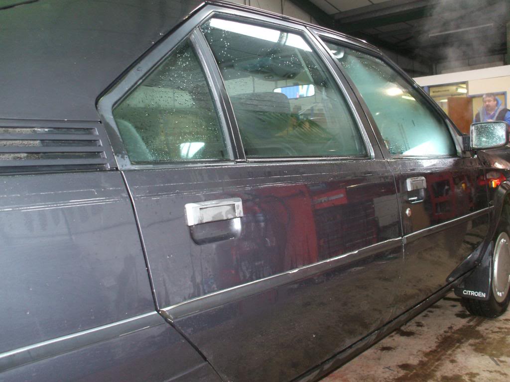

I used a wall paper steamer to soften the glue on my meteor stripes and tar and glue remover to take off any glue residue .
This what was left after using the steamer
The trick is not to leave the steamer in one place for too long .
