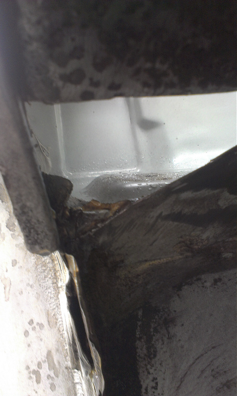

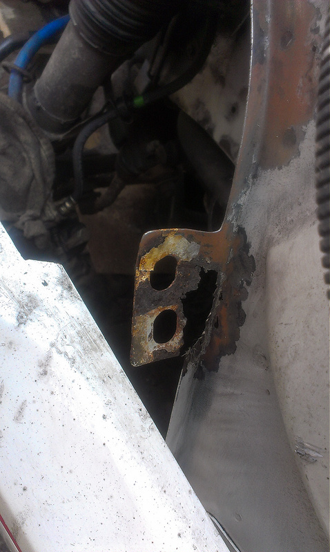

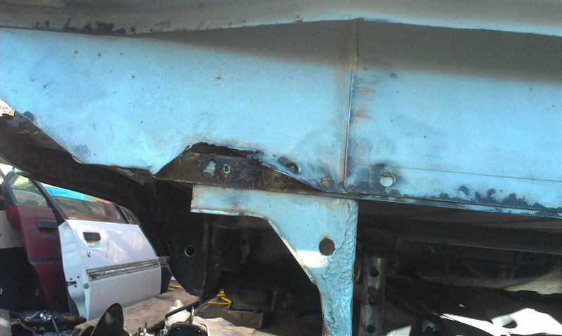

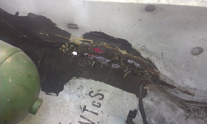

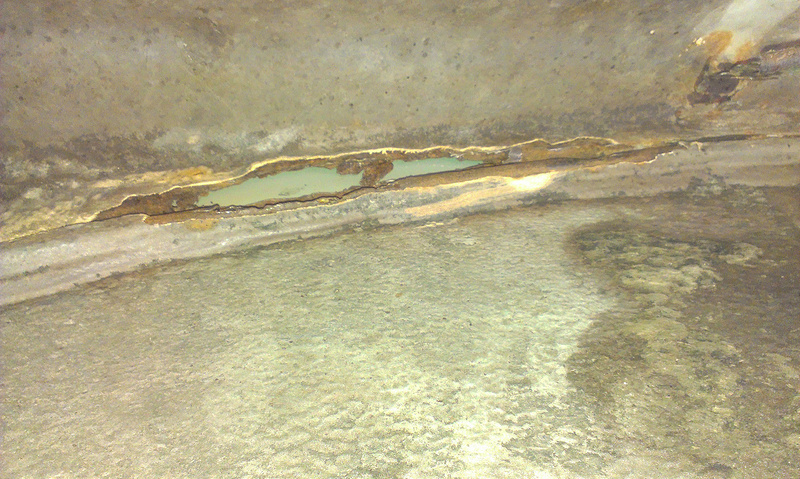

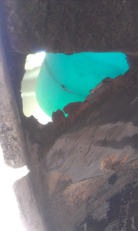

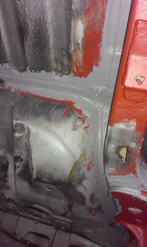

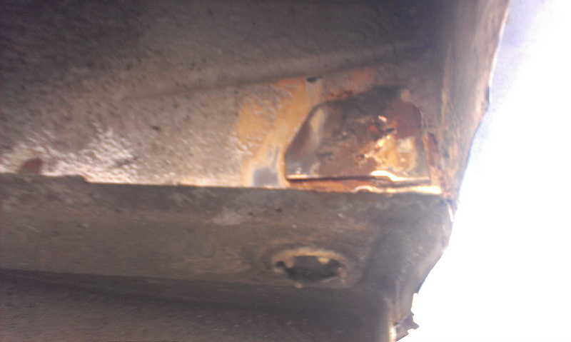

Thought I'd post some rust-porn pics of the TGD, as seems always to be the case with this car, bloody brilliant:
Amazed it's still hanging on!:
Can I get away with treatment and seam sealer on this one? No welding required I hope:
Perforation baby, perforation baby, this'll need cuttin'n'patchin'
Never quite understood why they all go here, a flap wheel, rust treatment and a weld job needed here:
Overall, not too shabby. If only I could stop sweating long enough to prevent welding in a salt bath, this car would be on the road!

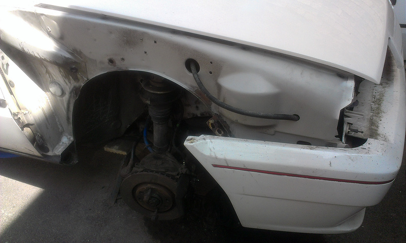

An update on Pidge, the whole front end is now welded up, rust free, full of black underbody stuff and filled with Bilt Hamber cavity wax.
I've cleaned and lubed the windscreen wiper mechanism, cleaned and lubed the dual cabin heater fan motors, all the black interior is in.
There are some minor rust areas on the sills, gladly no welding needed, just surface rust.

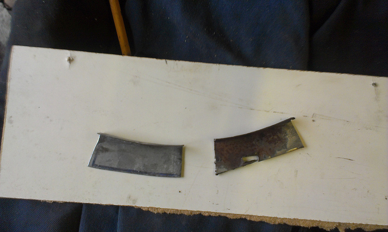

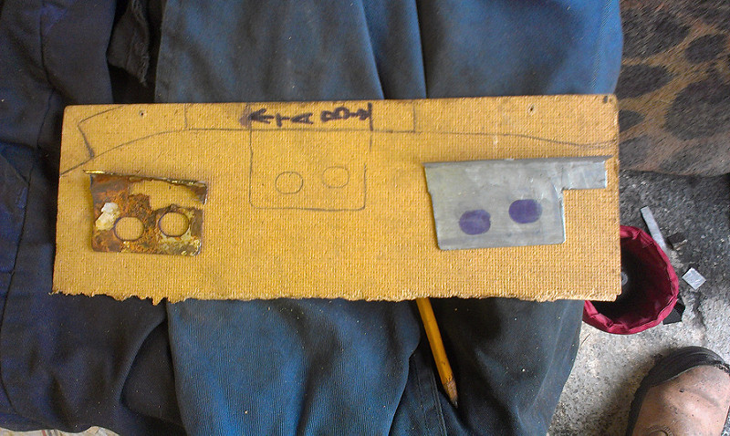

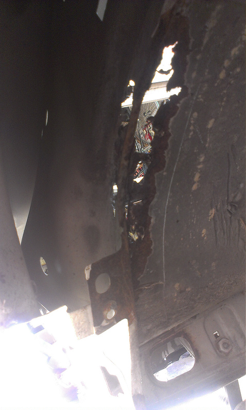

Making some bits up
Big hole under wash bottle/scuttle

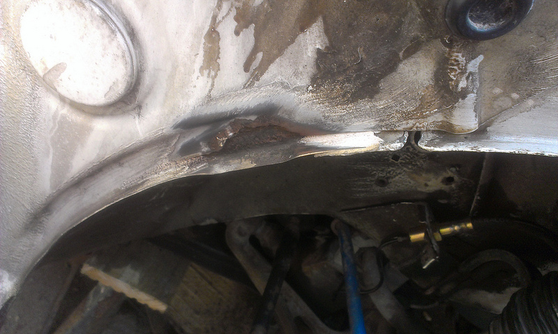

Hole along seam in inner wing, the day light is coming from inside the car.
Old rusty bits cut out
Wash bottle/scuttle hole repaired
Wing repaired
Wing repaired

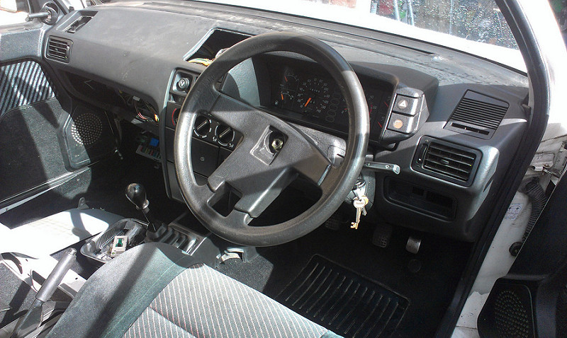

Got me gauges in, only the water temp guage rigged up for now
IMAG0686 by Neil Pye, on Flickr
All the grey gone now, all in black Johnny Cash style!
IMAG0687 by Neil Pye, on Flickr

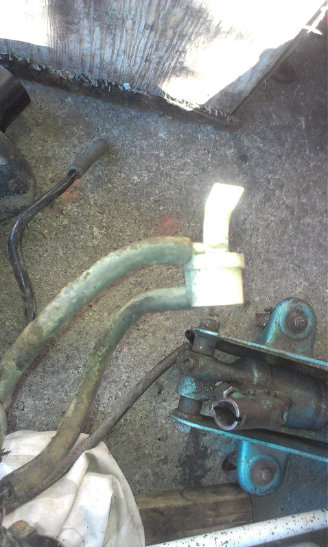

Onto the rear
IMAG0688 by Neil Pye, on Flickr

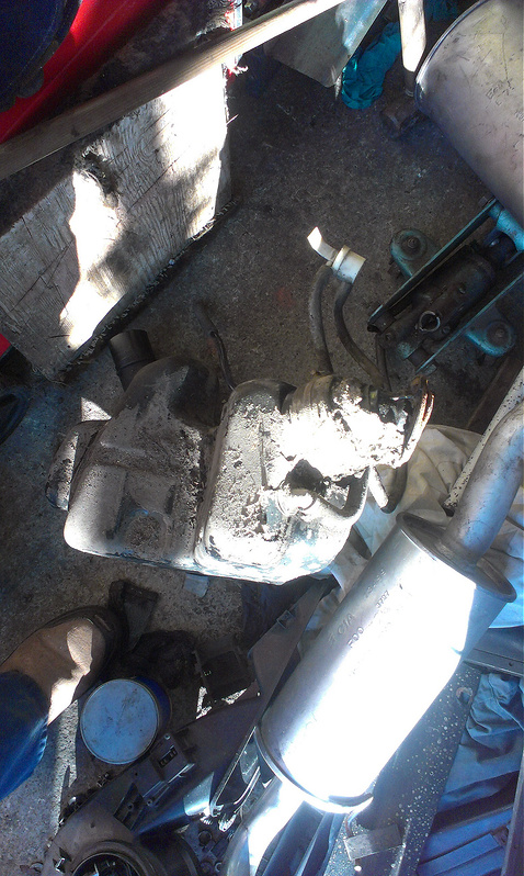

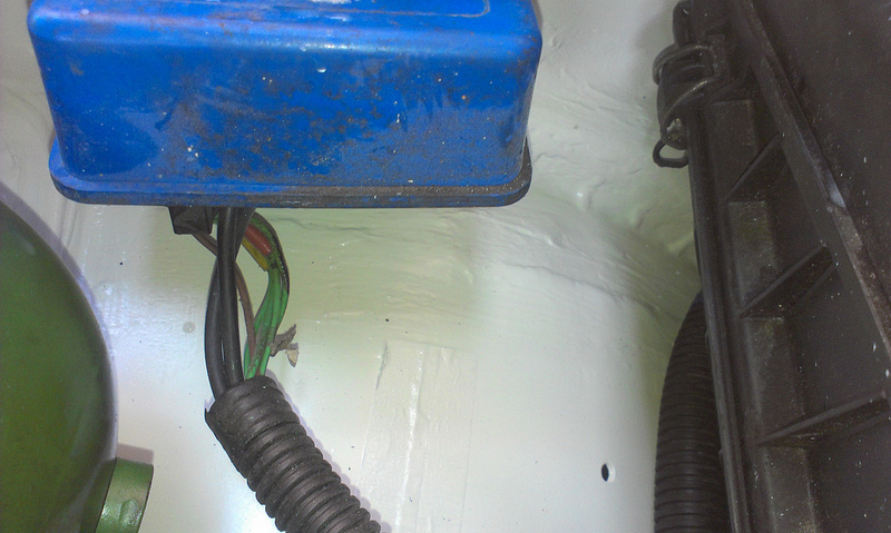

Does this thing have to be a certain way up? The bracket has turned to dust!
IMAG0689 by Neil Pye, on Flickr
My aux tank out
IMAG0690 by Neil Pye, on Flickr

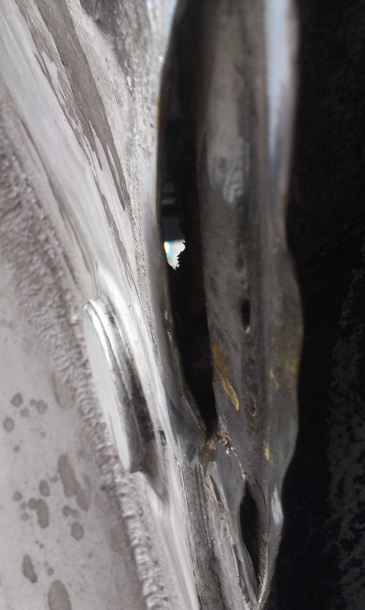

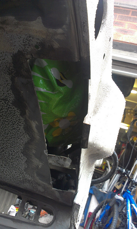

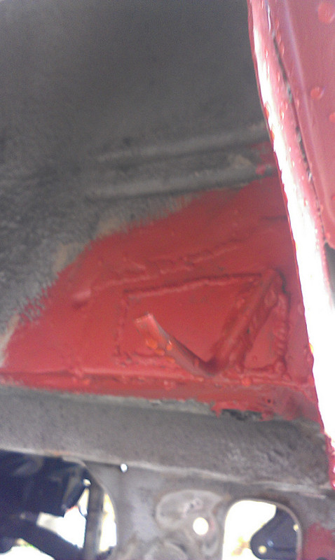

Big hole in my offside wheel arch
IMAG0691 by Neil Pye, on Flickr
Cleaned up, de-ox gelled and ready for primer
IMAG0692 by Neil Pye, on Flickr

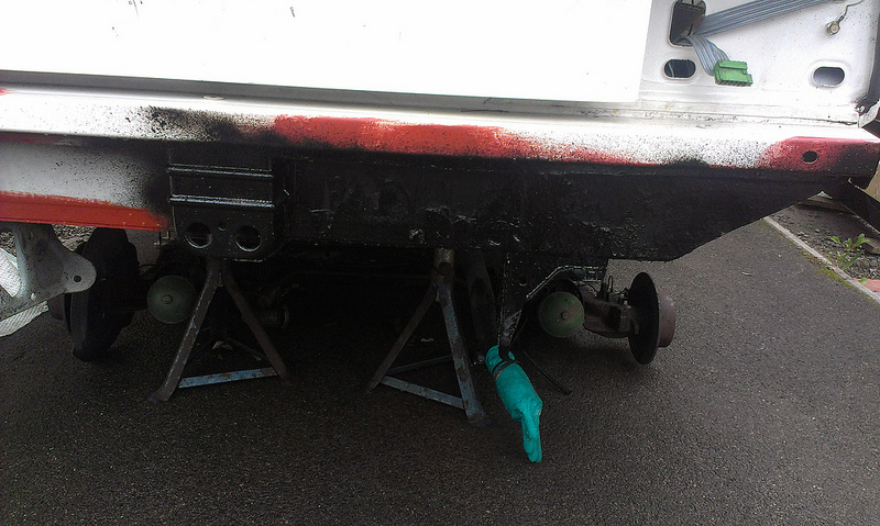

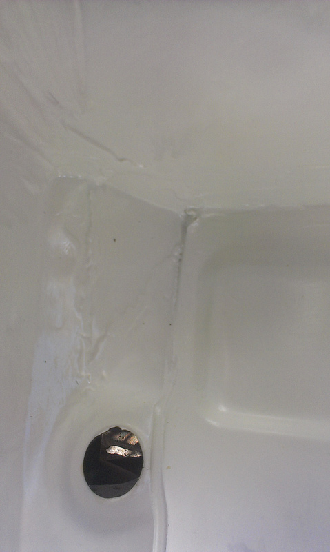

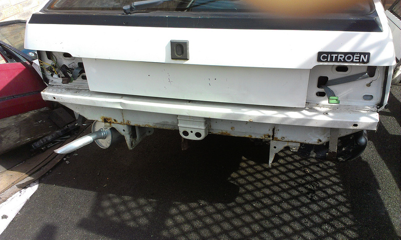

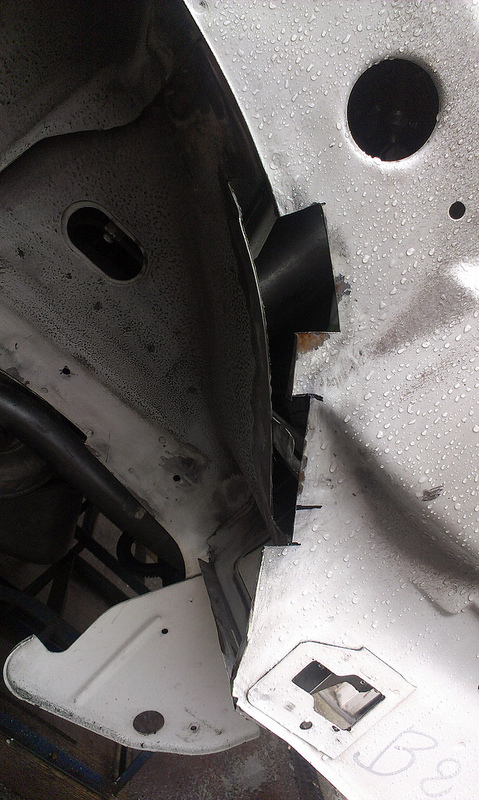

There's a hole in my boot!
IMAG0693 by Neil Pye, on Flickr
Someone pinched me exhaust hanger!
IMAG0694 by Neil Pye, on Flickr
I even dropped the fuel tank!
IMAG0696 by Neil Pye, on Flickr
Primed and seam sealed
IMAG0697 by Neil Pye, on Flickr
The hole I cut out to repair the perforation on the off side rear wheel arch
IMAG0698 by Neil Pye, on Flickr
Off side undersealed with a (hopefully) hard wearing long lasting blackness
IMAG0700 by Neil Pye, on Flickr
New exhaust hanger
IMAG0701 by Neil Pye, on Flickr
