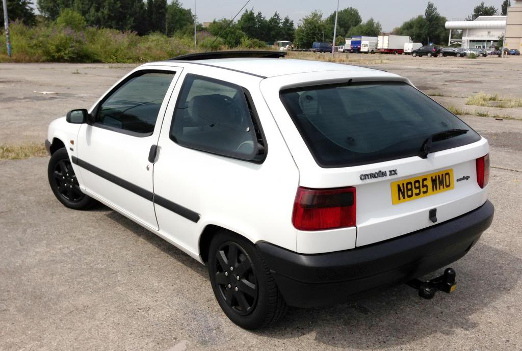

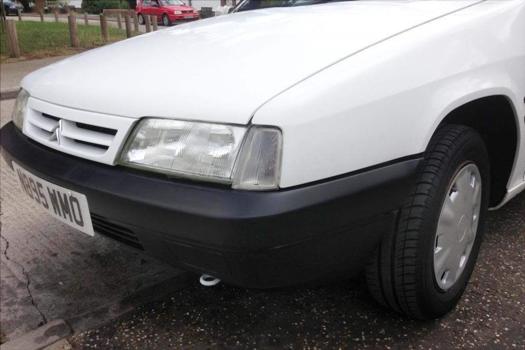

Over the Dennis (my long-time Citroen specialist) this morning, got the ZX up on ramps and had a good prod about. Car's nice and solid with evidence it's been maintained (new-ish parts including flexis and clutch cable), and the corrosion that's there isn't a problem at the moment (and to keep it at bay it was sprayed liberally in nooks and crannies with Dennis's cocktail of oily gunk). Brake discs and pads have another 10-12 months in them and there were no horrible shocks. The flexible joint on the exhaust, behind the engine, is blowing a bit. I'll get a kit and one day and when feeling brave will persuade Phil B to help replace it. So, seems the The White Knight is a solid basis for improvement...
And I attended to the bumper strips that were letting the car's appearance down badly.... worked out OK; The rear, which was the worst was a doddle; the trim strips are made up of a black plastic base, with a covering of foil-backed clear plastic. The latter came off easily et voila. Black strip. Front; not at all bad, but I wanted consistency. However, instead of try to get the top layer off (it wasn't coming away) I used a good quality black insulating tape and I have to say it looks not half bad.

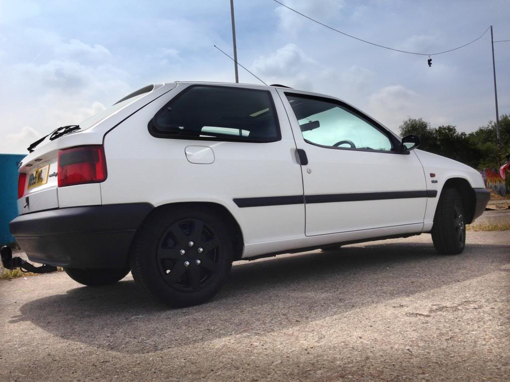

It might not meet with everyone's approval but I changed the trims for some I had in the shed. Glad I did; it looks the biz now (I think

I'm glad you do! I think I'd rather have sprayed the originals black (or possibly white in a move towards a 'St. Tropez' look!) Still, If you're happy with it that's all that matters.
