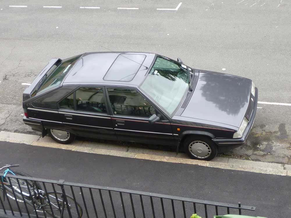

here is a photo of my lovely Bx 16 Meteor Auto from 1991. I am the second owner from new and the car has never been off the road. In the last 5 years I only did 5000 miles and in total it has 85000. I have always got everything fixed and just last year I had 2 brand new break calipers fitted. The interior is still in a very good and clean condition although on the body it has a few little bumps, 22 years, no accidents, no re sprays, no visible rust. Some people may not like the auto version but I love it.
The car has full service history and the octopus has been changed less than 5 years ago, now it has developed a new lhm leak, The stop lights came on before I went on holiday but it did not seem to drip whilst the car was parked for 2 weeks. Today it drips badly on the front driver side. Is it worth driving to a far away specialist and have this fixed. Mot is due at the end of the month and other that the drip it should be ok.
