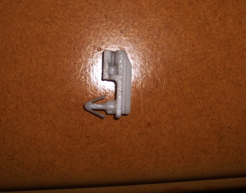

It seems to be the same on any BX I've looked at, and for that matter 205s as well - on which I've experienced the problem a few times! Carrying a spare with me in the BX would appear to be the magical talisman to prevent any further breakages though…
There's two flaps (or should be) which, once you've pushed it through the hole in the pedal spring back outwards and lock it in position. They can break off and allow the clip to separate.
EDIT - here's a photo I pinched after a quick Google image search, from a 106 forum:

Thanks Mat- can one get hold of the clip separately from the whole cable?

I don't really know, as I've only got them from scrapyards - but that was 10 years ago when BXs (and 205s!) were a lot more common. Worth asking a dealer but if not I'd try and find the most recent PSA vehicle that has one - maybe a late model 106 - and get a couple.

Re: Throttle cable plastic
Hi Rob,
I had this problem once when I took my lady-friends Pug 309 GRTD in for MOT once, when the Monkey which was doing the smoke test was Reving the engine up/down came into the reception/waiting area to tell me that the throttle cable had bust
So I went into the workshop to take a look and found the same problem that the white plastic hook on the end had come adrift from the throttle pedal end !
I could see that one of the tangs had broke off or even possibly both (It was a long time ago now and the car been long gone now so I can't check) !
Anyhow how the simple fix for this problem in situ is as follows:-
a) Just locate the right angled hook end back into position (In the pedal) .
b) Then get a very small/narrow cable-tie with the end already thro' the square end of the ratchet/tang and pull the tie down to approx. 5mm internal diameter.
c) Slip a thin steel washer with just enough clearance to fit over the dome-end of the plastic 'Hooked-end' (Whilst holding the 'Hook' in position of the throttle pedal) .
d) Then whilst still holding the plastic hook in position so as the steel washer /\ doesn't fall off with the other hand (By holding the long end of the cable tie) place the pre-engaged cable-tie over the nose of the dome-end of the plastic hook and pull the cable-tie fully home so it engages each side of the flats on the plastic hook (Now that the two tangs are out of the way/broke).
e) Trim of the surplus length of the cable tie so it does not foul any adjacent components around the pedal box area !
Never had a problem with the above fix on the 309 ever afterwards for the cost of a small washer and a cable-tie !
Worth keeping the above simple 'Repair kit' in your glove-box to save you getting stranded in the middle of no where
But I may have a spare Hook somewhere Rob. (If I find one, I'll PM you) but it may be quicker/easier just to go down to you nearest breakers yards and carefully recover one (But the Tangs do break off very easily) so it may take you a couple of vehicles to get the 'Knack' on removing in them one piece !
Good-luck
Good-luck

Tang! That's the word I was trying to think of but failed
