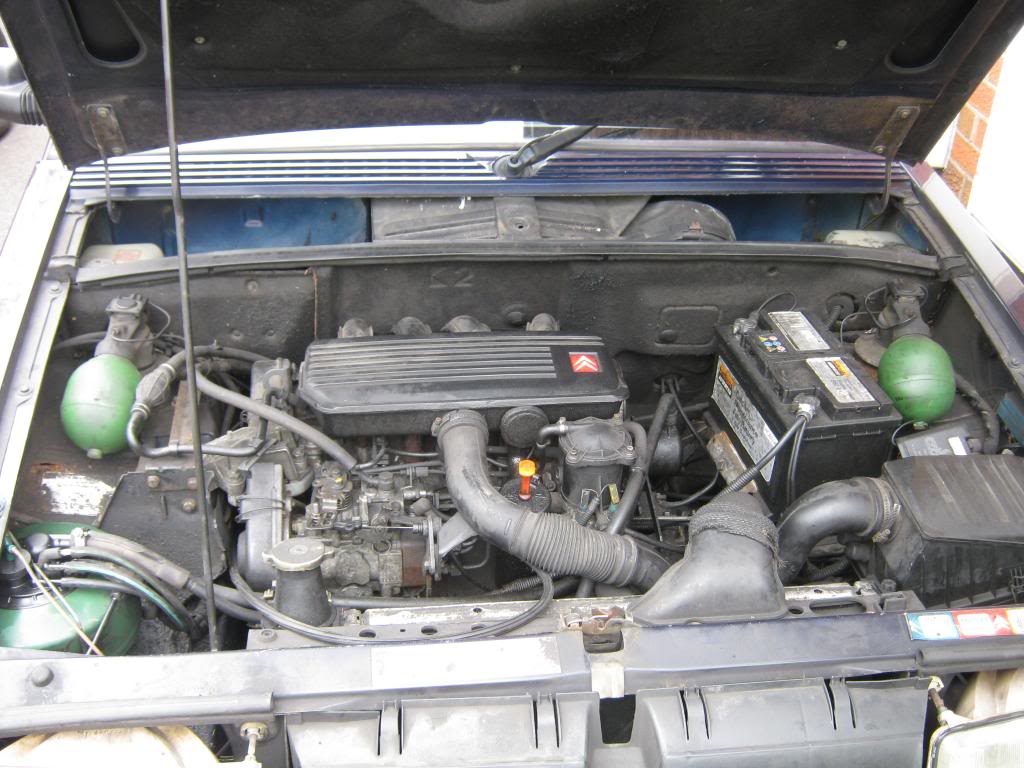

Just to clarify what filter setup I've got, here's a picture of the engine bay:

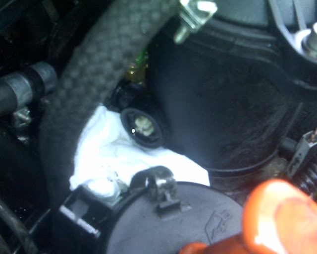

- Posts: 7330
Re: Intermittent Misfire/Stalling 19TXD
Apologies if you've already tried this, but did you see my photo above? If you haven't eliminated this as a possibility, try pumping the priming bulb while looking for leaks around the white thermostat valve. This allows diesel to flow through the heat exchanger passageways between the thermostat housing and filter during cold weather.
If it's leaking there when pumping, chances are the O ring behind needs replacing. I have an overhaul kit but rather would like to keep it on the shelf - I can give you the part no. or measure the relevant O ring for you if you need though?
EDIT - you mention plastic to plastic mating surfaces on the filter housing - there should be a rubber seal which fits around the rim of the filter, to seal between the lid and rim of the housing. If this is missing then that's likely to be the problem. Either way, you've successfully isolated it to the filter housing so that's a good start.
