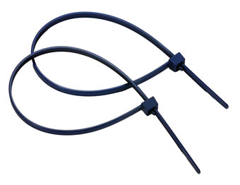

Re: Very Sloppy Gearchange
Tim Leech wrote:
Can anyone advise me what bits I need?
David

I had this problem on my car. It needed both long rods going from the gear stick to the steering rack replacing. They were so bad they just dropped off half the time.
They worked on mine whilst I found some replacements.
Defender110 wrote:Tim Leech wrote:
Can anyone advise me what bits I need?![]()

Haha dont tell me about tiewraps, my years of bodging with suhc items are hopefully past.
