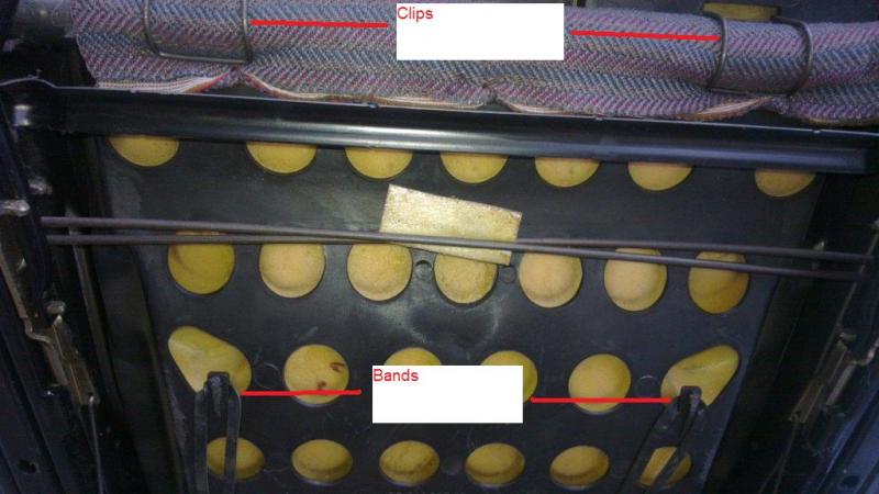

adamskibx wrote:Thanks Jaba - I did not know it was so easy to pull the squab out. If that's do-able then I'll have a look in a little while.
I suspect many owners are unaware of how easy it is to remove the squab!
If you look under the front of the seat you will see two metal clips on a round bar. Simply flip those forward to release. If you then raise the front of the squab a little you will see two "rubber bands" hooked onto the plastic support pan. Once the bands are released the squab will pull up and forward to remove.

Thank you MIchael. That diagram is a great help. I haven't looked yet. I will probably wait until tomorrow now as it's now dark, but the diagram explains it well. I did not know there was a hidden money box :-) Do I dare eat any chocolate raisins? :shock:
