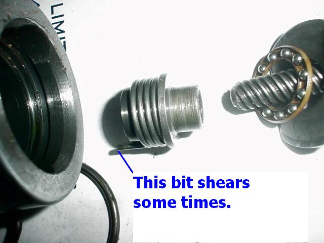

There is a small spring that resides inside the piston that sometimes breaks,
the protruding piece of this spring sheers off.
If this happens, then the handbrake will not adjust.
I will see if I can take a picture to help..

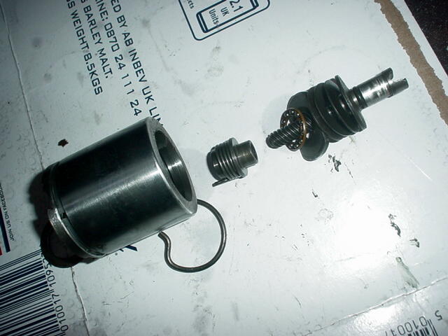

Right, I could not find the original picture, so I took another two.
Hope this helps any one who has not completely dismantled a calliper before.
Take care when removing the very strong circlip, "eye protection ".
Also make sure the "Dished Spring Discs" are assembled correctly.

Good pictures Brian thanks.

Yes, fantastic pictures, thanks. The spring looks sturdy enough, surely it must be broken by abuse rather than wear ?

I've got a couple of those recon kits (95590796) which I found NOS a while back, and although they have the dished spring washers, they don't seem to have the thrust (ball bearing) washer or the spring that's shown in Brian's photo....
