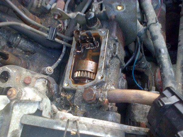

After work yesterday I actually had some daylight and dry weather, so took the top off the pump:
Not much wiser as a result though! I assume the gear is driven off a shaft driven by the cambelt. The levers at the other end move, but I don't know if they move enough! They seem to press against the shaft that the gear runs on - is that supposed to slide or something? Thefact some of it seems to have a light coating of rust doesn't exactly fill me with confidence either!

Re: 17rd will only run flat out
I'd say the colour of those internals does not look good. Looks like rust has got a grip! It's all supposed to be spotless and clean inside there. I'd suggest look for a good used pump and swop it over. It can be done by leaving the belt wheel clamped in place to the engine - that way cam belt is not disturbed. Steve
