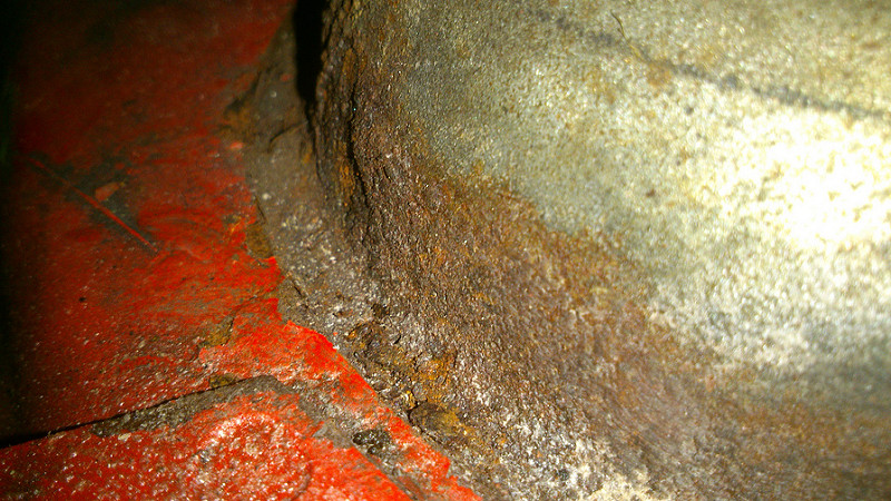

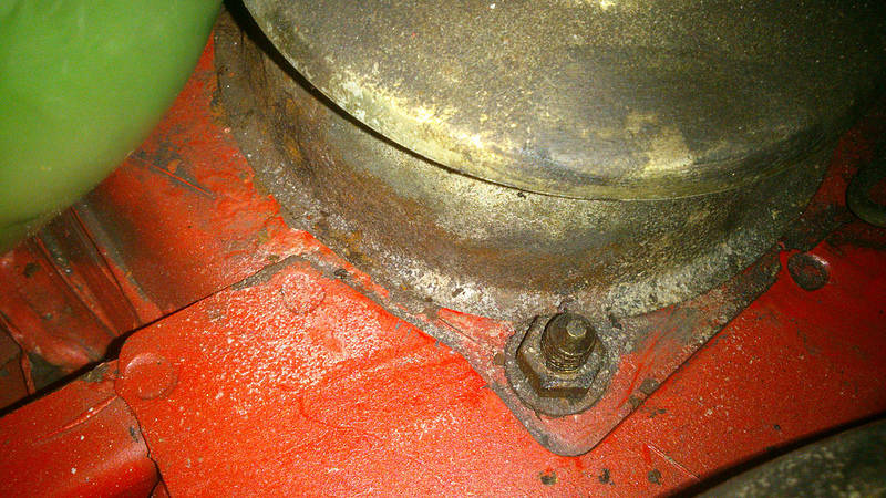

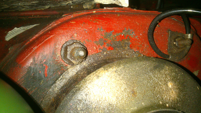

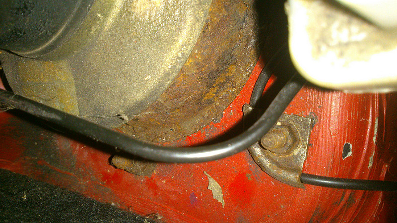

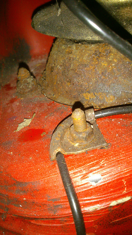

Was looking for the strut returns so that I could put LHM into the creaking struts but discovered something more scary in the process The tops of both front struts are very rusty Opinions and advice welcome

I thought it was only XM's and Xantia's that suffered rusty strut tops. Kieran, I sent my XM struts away to a company in Lithuania for a refurbishment. Not sure if they can do the same for a BX, as the XM struts are rubber bonded. Here's the link to kinGAS. http://www.elastomer.eu/index.php/en/" onclick="window.open(this.href);return false;
Re: Front strut tops rust
That's very unusual I think. It could be a good thing that it is a replaceable part easily sourced from a scrap car, and it looks like the surrounding metal is, mainly, OK. On a side note I found that there is a hole on the inside of the strut top where you can see the shiny piston of the strut, and pouring LHM onto/into this does wonders I found. But yes, I would look out for a way to get new strut tops as it should be a reasonably simple job to swap them.

I'd rub them down to see if its just surface rust, hopefully it doesn't go too deep, they would have originally been wrapped in rubber so that you couldn't see the metal. If they rub down ok, i'd just treat them with some kurust & possibly paint them with some of that anti rust paint & then just keep an eye on them, they probably look worse than they actually are

Thanks for the advice guys. So it sounds like this isnt a very common thing? What happened to the original rubber? To be honest I was quite shocked to see them so bad! Would it be worth taking them out to rub them down with a wire brush and paint as you suggest Mulley?

The old rubber will have perished and come unstuck from the steel. I'd definately remove them to clean up. As I understand it there's rubber underneath aswell, and it's this that's the important bit to still be bonded to the steel. If it's still all together then a clean up and paint of the exposed steel should preserve things.

My TXD has rusty strut tops, infact you could argue that as the rubber ages, it lets moisture in & therefore it makes matters worse. Just clean them up & paint them, i'm sure they will be fine.
