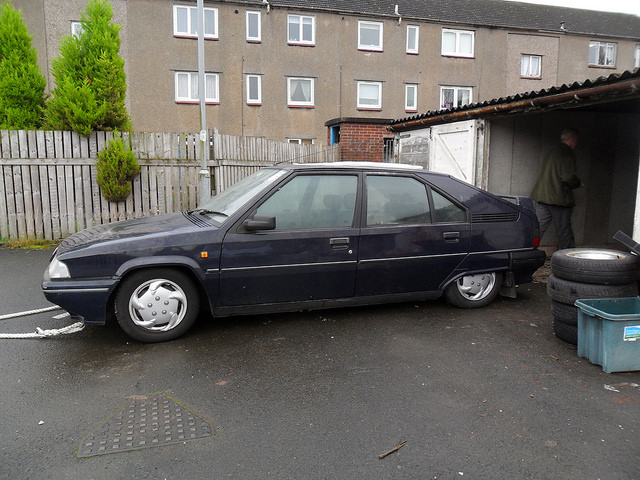

It did get pulled out last year to get at some things behind/beside it:
SAM_2446 by macplaxton, on Flickr
But due to distance a big bit of water to swim, I haven't got near it until recently. More to come.

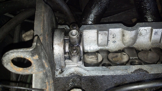

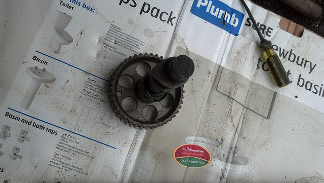

This car gave up moving under its own power at a junction at low speed. It was switched off immediately and brought back to base. A suspected belt jump and shredding. 30k previous at around 139k, it had a new cambelt fitted, but it did have a background issue with there being no tensioner-slot lock bolt, the thread in the head having been stripped/crossed. So it had done rather well considering.

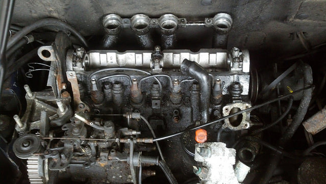

I'd managed to take some ancillaries off before now,
IMG_20150313_112452_435 by macplaxton, on Flickr

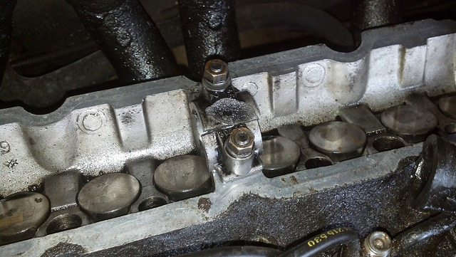

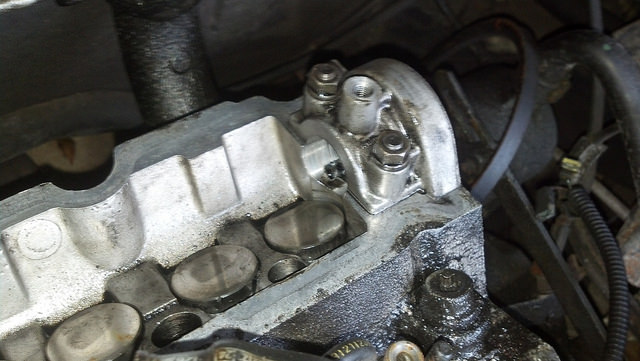

Damage this time round amounted to a one break in the camshaft and a centre cam cap trashed.
IMG_20150313_112531_156 by macplaxton, on Flickr
IMG_20150313_112519_801 by macplaxton, on Flickr
IMG_20150313_112513_447 by macplaxton, on Flickr
IMG_20150313_112525_786 by macplaxton, on Flickr
No other damage noted so far, but I've yet to get the head over here and in front of me on the bench for very close inspection.

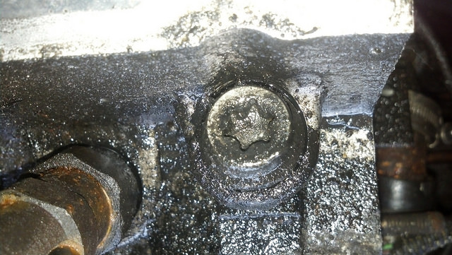

The borrowed tools lacked some of the things I needed (as well as my note not having requested in the first place), so rather than waste time, it was off to Halfords to see what was on 1/2 price sale in the big sets. Oh good, there is a 1/2 price sale on! I'd forgot about these modern funny head bolts with their Torx heads for starters, so lets find a set with them.

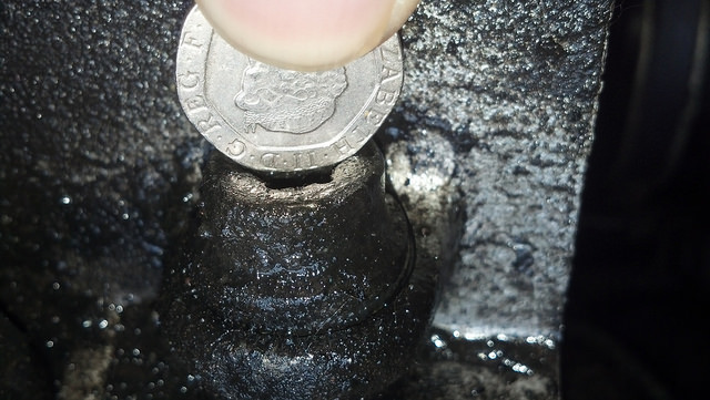

What size are they?
IMG_20150313_114249_843 by macplaxton, on Flickr
This size! (About the width of queeny's head)
IMG_20150313_114403_655 by macplaxton, on Flickr

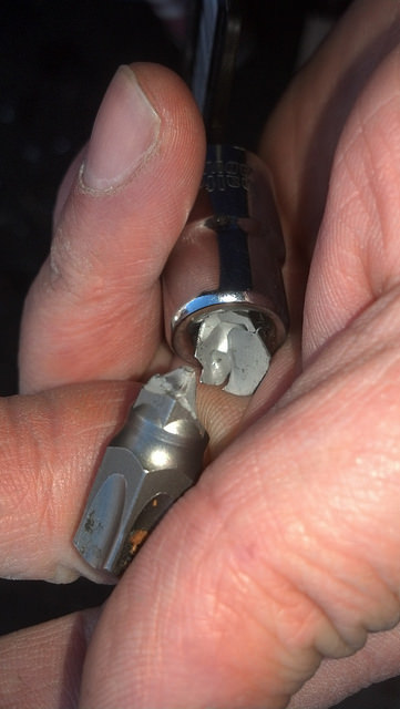

Arse. I was only using the included 7" long 3/8" drive breaker bar.
(As a distraction, when my driver re-appeared with his 8 spark plugs for his Honda Jazz, I decided to just change them there and then. At least that would go right. 35 minutes later all done without any drama)
Oh well, back to the shop to claim my lifetime guarantee 1 hour into ownership. Also to see if they have a 1/2" drive TX55 bit that doesn't have a slimmed down cross-section. Bingo on both counts and back to the lockup (but not before grabbing a 600mm breaker bar). Hmmm, another problem rears it head. The 1/2" drive TX55 whilst beefy enough to deal with front head bolt near the timing belt cover, is too beefy where it counts to do the one behind. Ok, I'll just try this 3/8" one before I give up. Ooops, broke that one too. Back down to Halfords and get other 3/8" replacement and no they don't have any 1/2" ones in long (the only thing remotely close was a set of Laser Ribe ones - grrr). So a bit of running round Paisley on a Friday afternoon wasn't looking good until I hit one of the small local factors, who came up trumps.

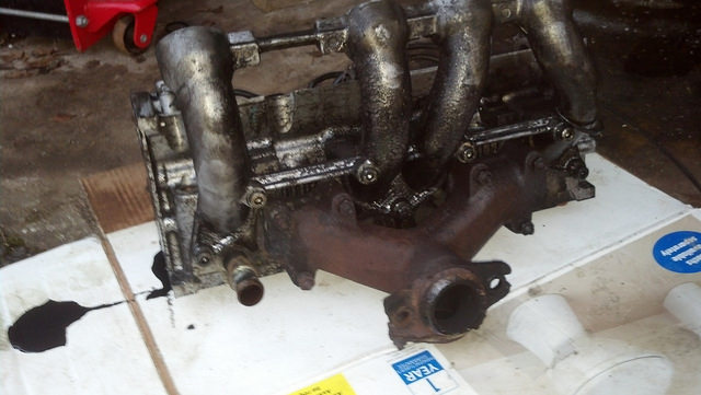

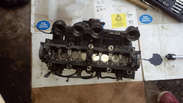

Finally. Head off.
IMG_20150313_173951_784 by macplaxton, on Flickr
IMG_20150313_174004_221 by macplaxton, on Flickr
What size are they?

And back to the lockup to quickly end up with this.
IMG_20150313_145838_657 by macplaxton, on Flickr

Finally. Head off.
