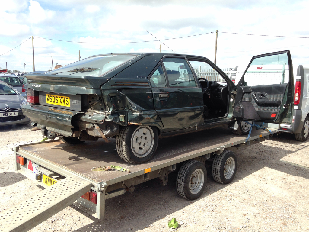

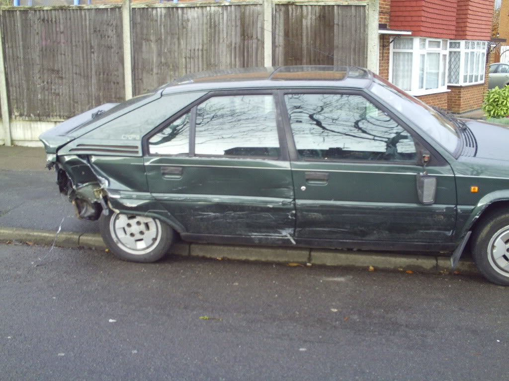

Here's the car 3 years ago
Two weeks ago it was collected by North Herts College it be repaired .
It will be used to train the students on how to repair a crash damaged car which is a win win situation as they gain experience and we get the car repaired .
On its way

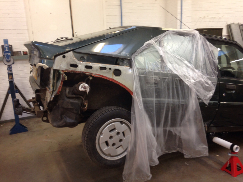

Two weeks later the rear of the car has been pulled out the damaged rear 1/4 panel has been removed and the rear panel needs to be straighten a bit more , the inner wing has a small amount of damage but not too bad and the tailgate has a small piece missing which you can see in the pictures is being repaired they also managed to remove the 16v style air vent from the rear 1/4 without damaging it :D

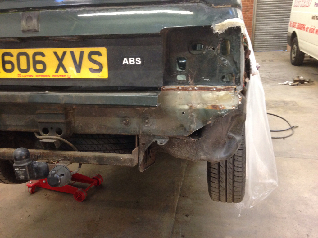

They cut off the crushed bumper support on the rear panel and once the rear panel is straight they will be making a new piece to fit back on , the small fuel tank has been crushed but it's not split and I am going to try and get it back to shape using a hot air gun and some carefull manipulation .
The rear 1/4 will be replaced by a panel supplied by Paul that he had cut out of a scrap car.

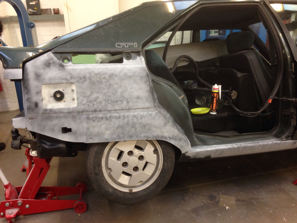

A bit more progress , rear inner wing straightened rear 1/4 replaced and dent in outer sill pulled out rear bumper support straighten and re welded on , they could have fabricated a new panel but Andy who is charge of the students wanted them to repair it rather than just fit new parts and a great job they are doing.
The car is comming back home for a while as the collage is relocating a few miles up the road , once they have moved repaired panels will be resprayed

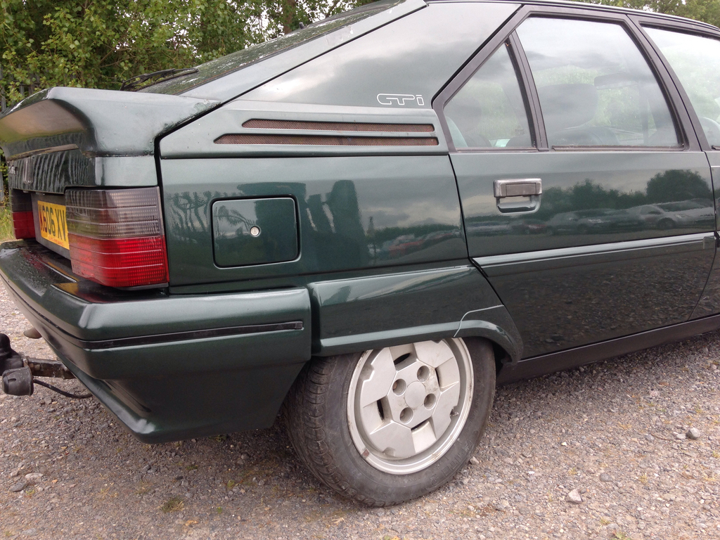

Things are going well rear 1/4 and bumper have been painted ,front door and wing still to be repaired but the college is moving so car had to come out of there for now .
The whole car could do with a respray but that will have to wait.
It also passed its mot

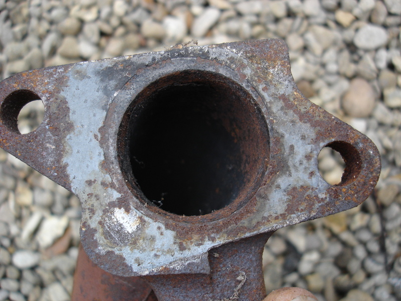

I have noticed when cold the exhaust is noisy sounds like a cracked manifold Noise disappear's when hot.
I did replace the gaskets but that was 3 years ago , so if anyone has a exhaust manifold for a 8 valve GTi please let me know.

Hi Gary
My tzi has the same issue with the exhaust, I'm sure it's the manifold, but I can't find where!
Hurricane looks great!
Posts: 2031
x 116
Re: The Hurricane rebuild

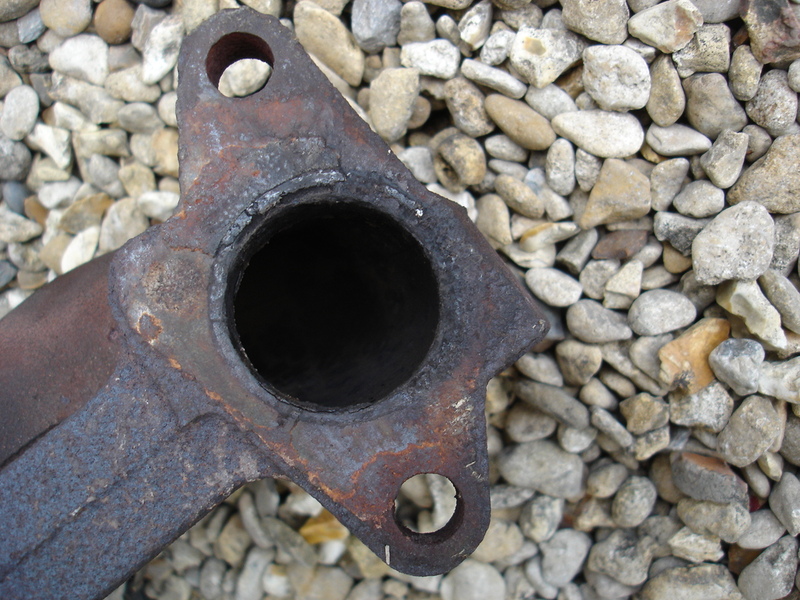

Me too and I have two manifolds with farting exhausts.
I think the problem is with the two outside flanges, and don't forget this is a cast iron manifold, that don't have a great deal of width for the gasket to seal on. I have found that the surface rusts away on the surface once a leak starts.
To save a thousand words here are pictures :
Despite using exhaust cement 3 years previously the carbon tracks of incipient escaping exhaust can be seen on manifold #1.
Next here is manifold #2 which has much rust evident and needs some attention to regain a good flat surface. I might just get it machined flat
Exit right :arrow:
