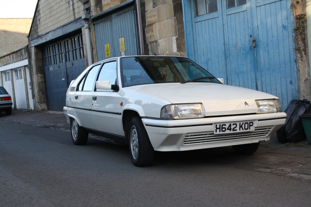

I have recently got my first BX, a white 19TGD.
It used to have the plate "BX 1700", so I believe it may have belonged to someone on here.

However we have a case of serious sheds in this picture. I struggle not to be distracted.

Ah yes, I rather like that photo, it's one of my better ones.
