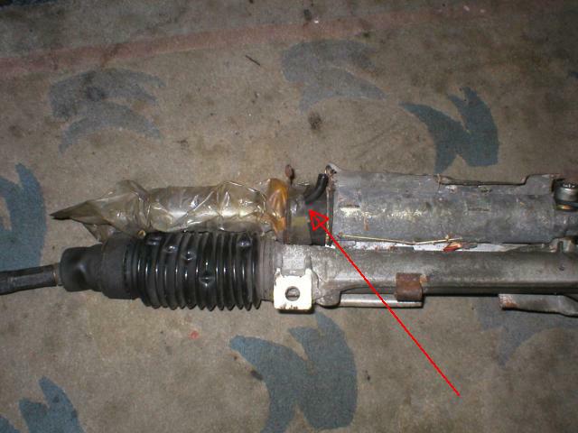

One wee question regarding the leakage return pipe, as pictured on the rack below, I'm wondering if my clear plastic return pipe is broken inside the rubber take off (arrowed) It only pushes in about 10mm and feels quite flimsy inside the rubber bit, is this normal or has it been broken at some time? I've borrowed a pic of a Xantia rack from the internet but it looks pretty much the same anyway.
Regards, Jim

The small plastic pipe only pushes in about half an inch or so, tho it is a low ptessure pipe it should be ok, a small cable tie around it or a sprung steel clamp should give some extra security.

It feels tight enough in the rubber bit, I just thought the rubber bit would have been a bit stiffer! All seems to be working fine so that's the main thing
Cheers Jim
