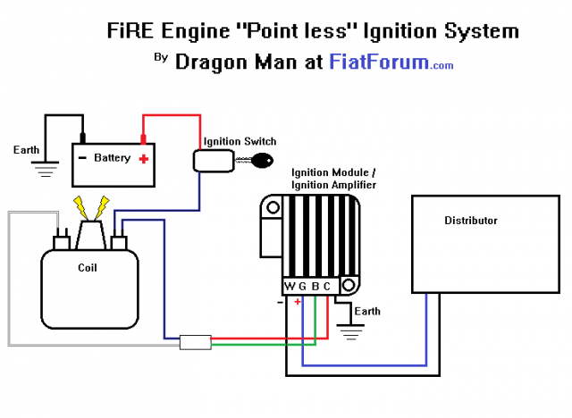

it sounds just like ignition module issues to me. i have an old Fiat Panda 4x4 (i have a few actually) and many of them have this issue. they are a pain in the ass and i always carry a spare in each car.
the ignition module replaces the points. using a magnetic/hall sensor in some ways its loads better as you never need to replace or adjust points. but they do have this issue of just dying. it happened to me on the motorway back from touring around Scotland in my 91 panda 4x4 sisley. i had no spare at the time so had to be recovered some 400 miles back home hahaha
most of the time you can adapt other ignition modules from other cars to fit yours (my current one is using one from a BMW!
they all work the same, mostly just using 4 or 5 wires. a ignition live, an earth to the - side of the coil, an earth and the rest go to the hall/magnetic sensor.
heres a picture i did of the panda 4x4 ignition module as they are well known for failing over in Fiat land.
hope this helps!
- JohnDragonMan
