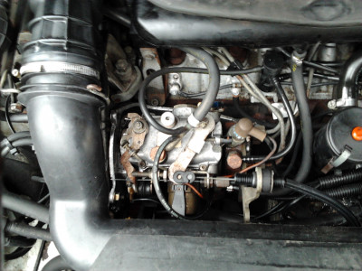

I've had a good look, even steam cleaned the pump but I can't identify what make it is. How do I tell the difference?
- Posts: 1767
- Location: Normandy
- x 4
Re: Diesel Pump
I can dig out pics tomorrow, but easier if you post a pic of your pump in situ - easy enough to identify that way.

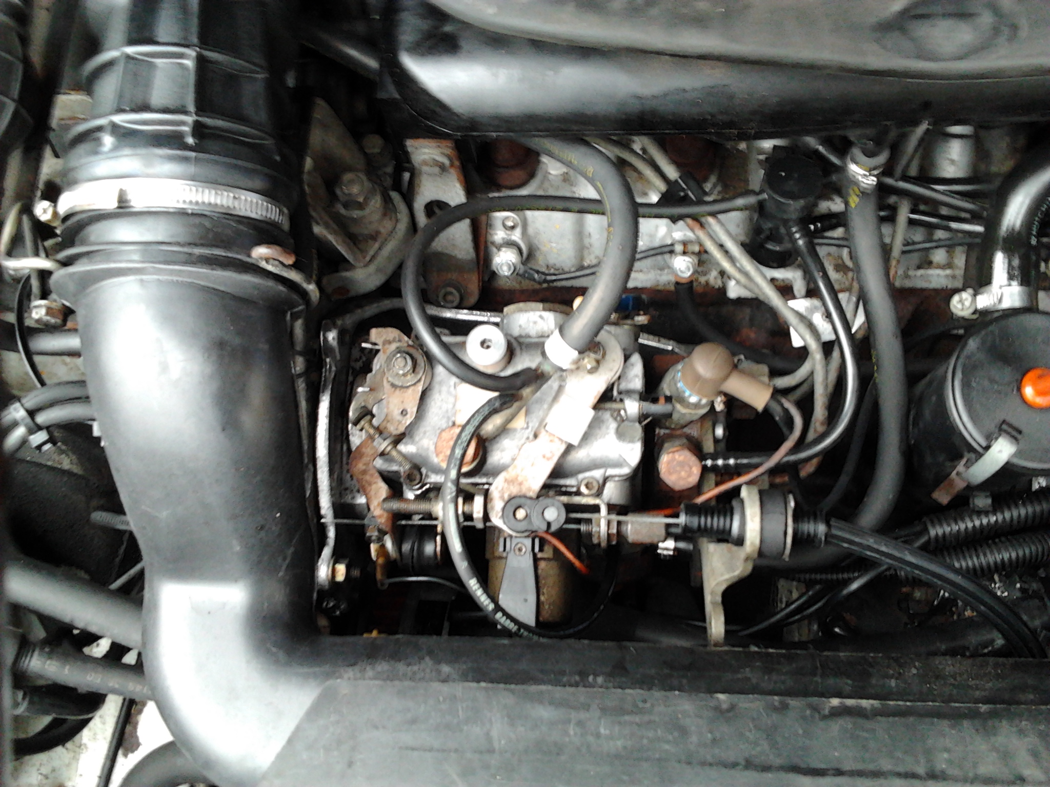

Re: Diesel Pump
Here's a pic of the pump.

Hi KevR. It looks the same as the cover offered on the diesel site you suggested. To change the throttle shaft seal do I have to remove the whole cover or can I pull the shaft out and re ring it. Sorry to be so ill informed but actually doing under bonnet work is new to me. What size rubber rings do I need? I ask because once I take the pump apart I have no way of getting to the shops until it's put back together so I need the parts before I attempt it. Cheers Bud.
- Posts: 1767
- x 4
Re: Diesel Pump
Yes, it;s a Lucas CAV pump. You have to remove the cover, because the shaft comes out from underneath, once you remove the nut on top and the accelerator arm. I don't know the size off the top of my head I'm afraid - I have a big box of assorted O rings and I just chose a couple that fitted. By the sound of it, you'll be much better off ordering a new top cover and doing the job once/properly. Just replacing the O rings will only be a temporary fix.
