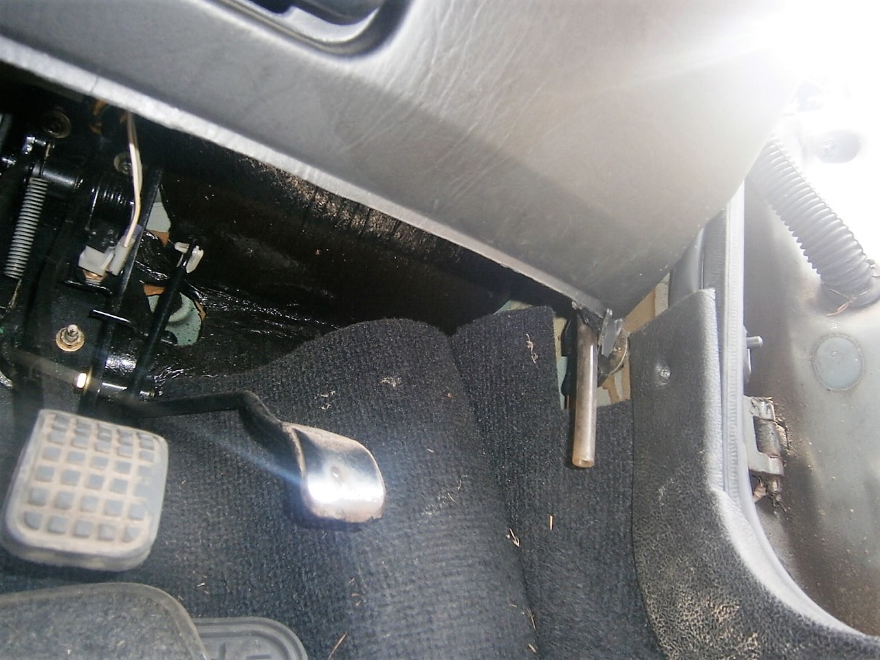

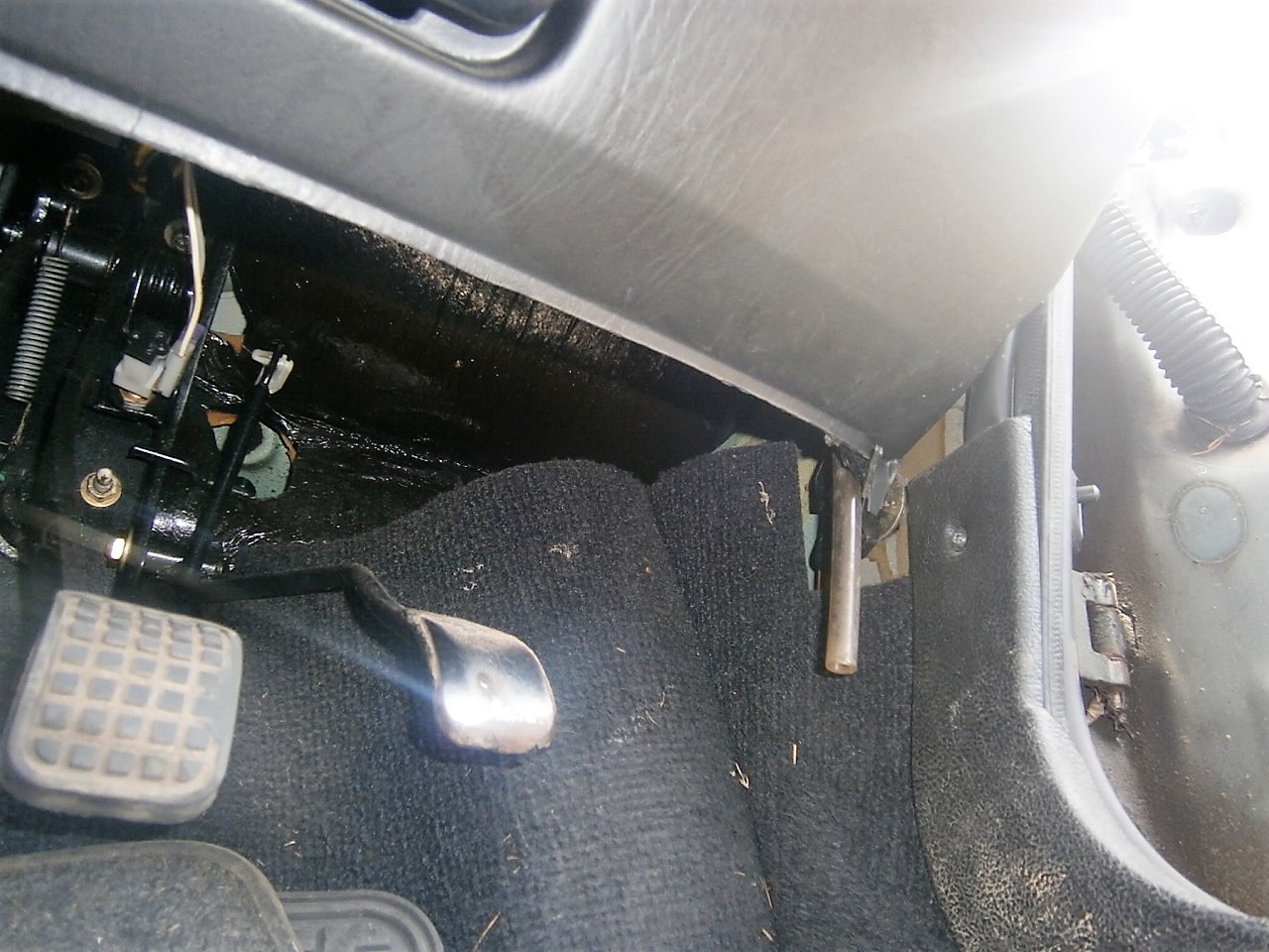

There are four of them and they plug into the moulded plastic tray attached to the underside of the roof, at each corner. It is not possible access them from the sunroof itself, without major dismantling, ie removing the headlining. So they need to be blown through from their outlets.
The front two pipes pass through the A posts behind and terminate in the inside of the front wings. There is a fluted outlet in the door shut where the A post meets the cill, to drain the water. The pipe can be accessed inside the footwell. On the inner vertical panel beside the accelerator pedal there is a small hole and the clear plastic pipe can be hooked out. On the Passenger side the hole is obscured by the fuse box so this needs to be pulled out, a simple task as it is designed to allow for this. Again there is a small hole at the junction with the dashboard panel from where the pipe can be hooked out.

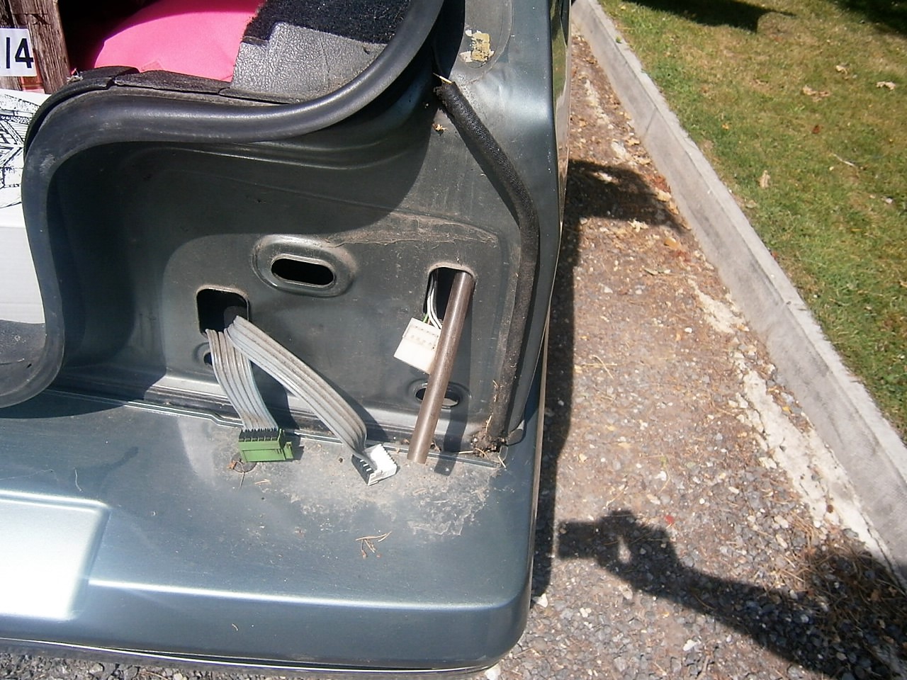

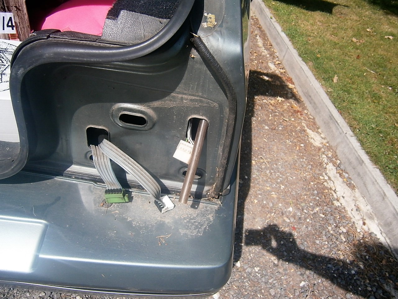

The rear pipes are easy. They are accessed bit removing the light cluster and then they can be hooked out from within the rear panel via the access holes. These pipes discharge over the steel panel behind the bumper, I wondered if this is why the panel is so prone to rust in these areas?. Maybe it’s worth extending these pipes to avoid this. I blew the pipes through with compressed air which appear to have cleared them.
