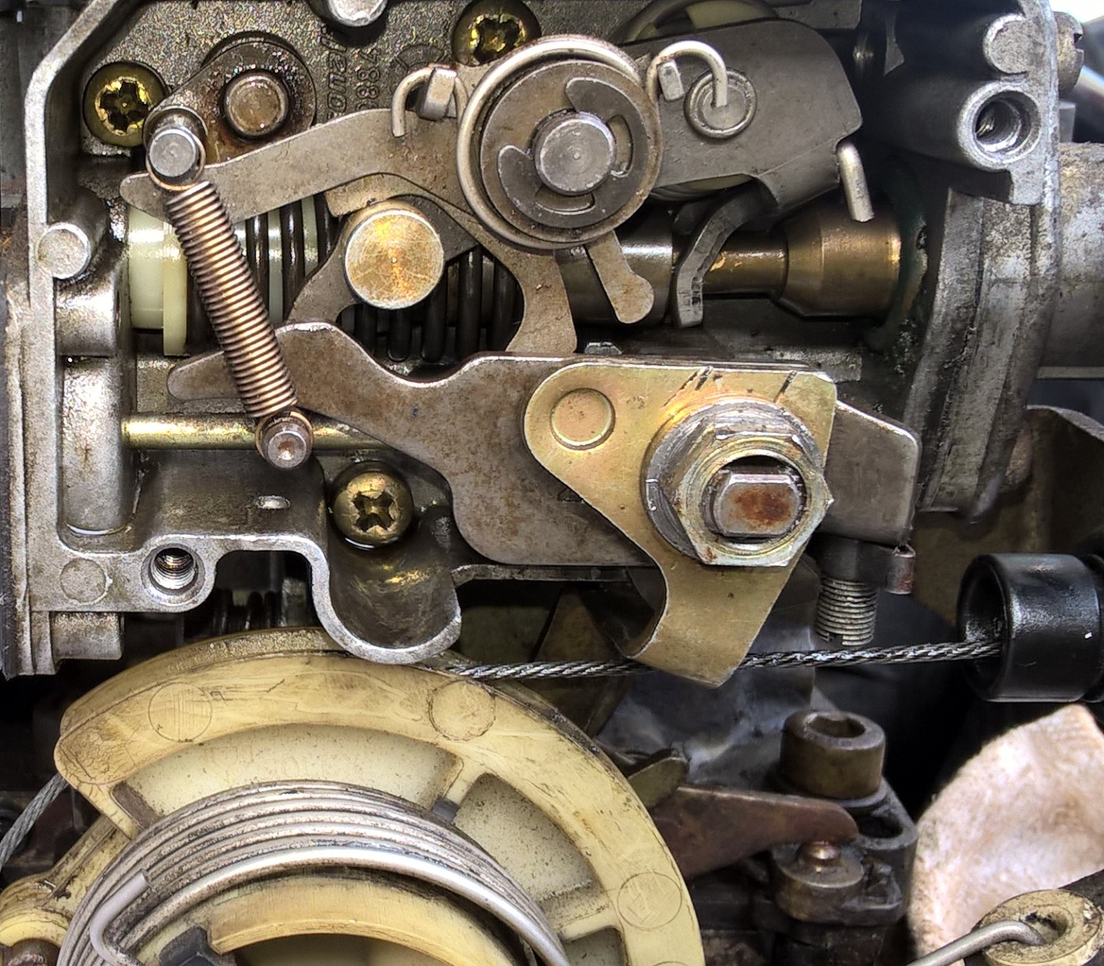

The first pic is of the cold carburettor with no throttle being applied. Behind the lock-nuts just to the right of image centre there are visible two cams -- a brass one and a steel one behind it. Passing thru the steel cam on its forward facing extension is a screw with a clip over it -- I understand this to be the fast idle setting screw. The screw abuts nothing at all on either end. Curious, methinks.

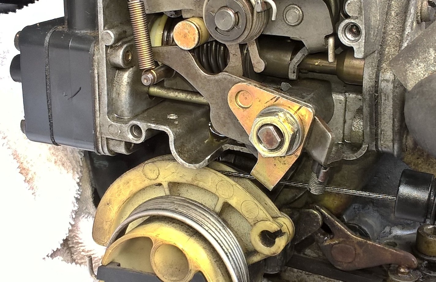

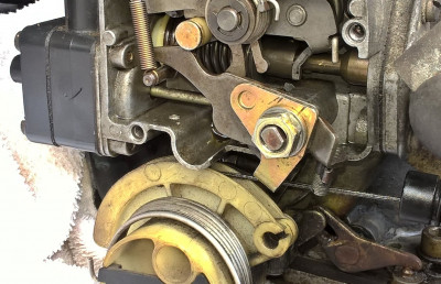

The second pic is the cold carb with the throttle cable being pulled on fully to simulate the accelerator pedal down condition. Again the brass and steel cam are evident in the image. But look under the steel cam and part of a third cam is visible, under the steel cam and extending to left and right behind the brass cam. The tip of this third cam can be seen contacting the screw secured in the middle cam, but laterally, not end-on. This does not comply with my documentation. Curiouser, methinks. (Non-compliance with the documentation is not unknown in the software world; rather, it is quite usual).
So the situation appears to be this. The fast idle screw is in contact with fresh air over most of the throttle cable travel, and is pushed on (by the innermost cam) only when the throttle is effectively 90% down. Which seems nuts.
Yes, the nuts. The obvious thing occurs to me -- undo the lock nuts, extract the cams, and see if the third cam behind can be remounted in a way to contact the fast idle screw end on, as it strongly appears to me God intended it to. Unfortunately my assorted spanners are all too fat, and my assorted needle nose pliers all too thin, so my obvious is temporarily deferred. On the other hand, my obvious thing may not be someone else's obvious thing, particularly one more knowledgeable about Soleces than I, so I could be wrong in my deduction that the absence of high idle revs when starting is due to the configuration of the auto-choke mechanism.
